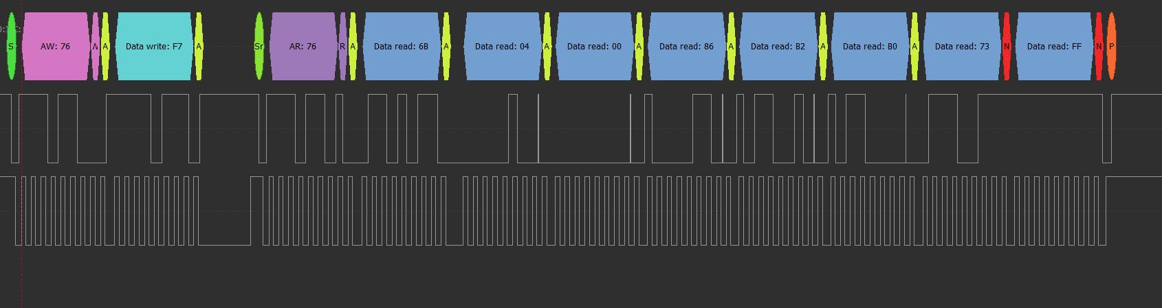

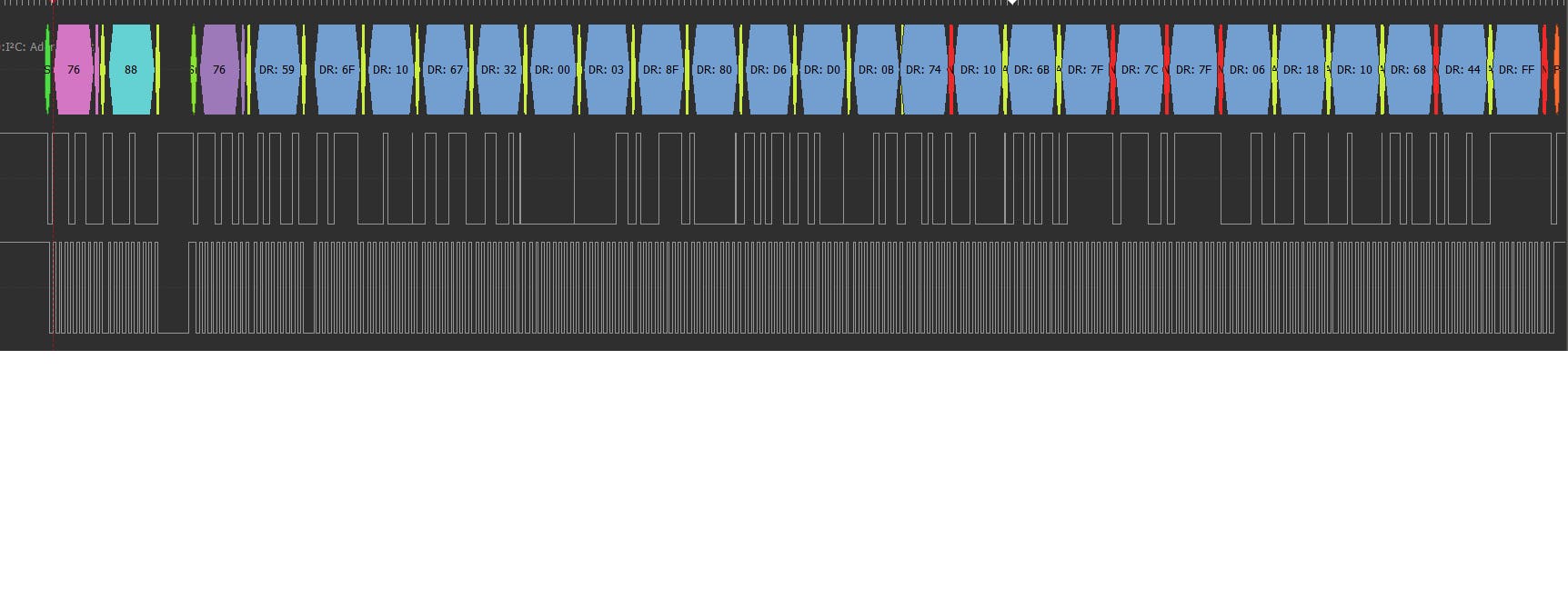

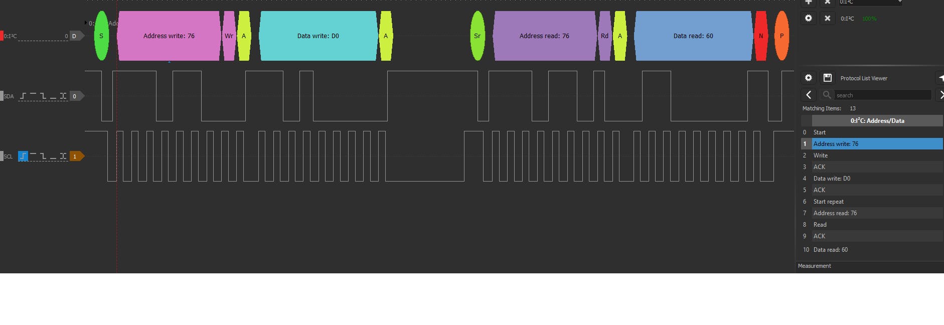

Below are sample pictures of the I2C communication
