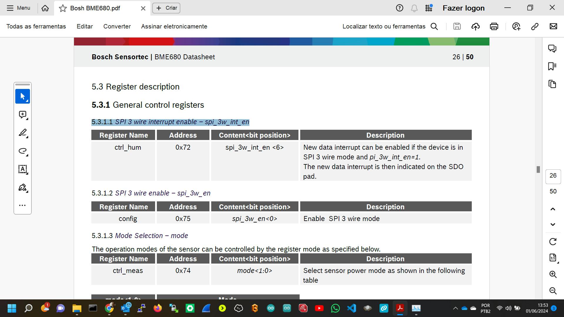

I was reading the "Bosch Sensortec | BME680 Datasheet" and I saw item "5.3.1.1 SPI 3 wire interrupt enable – spi_3w_int_en" that "New data interrupt can be enabled if the device is in SPI 3 wire mode and pi_3w_int_en=1. The new data interrupt is then indicated on the SDO pad".
Could I use this data interrupt (low/high) to create a low power profile behavior for the solution (MCU and sensor) sleep/wake up?
