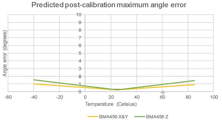

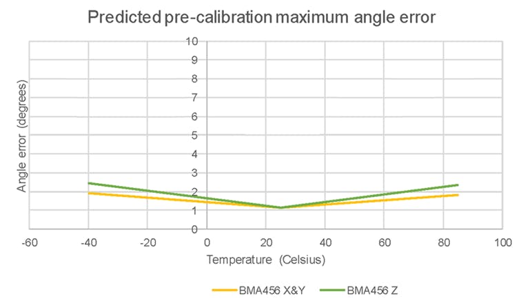

Calibrating the sensor
The first question to ask concerning calibration is whether it is required for the intended application. Accelerometer calibration mainly consists of calibrating the accelerometer's offset. The main impact for this is in tilt-sensing application, where the offset will induce an error in the measurement of the horizon.
The accelerometer comes from the factory pre-trimmed, but the soldering process and PCB bending due to assembly can vary the offset, therefore it is preferable to calibrate the accelerometer after assembling the device into the device housing.
Pre- and post-calibration accuracy
Sample code
The calibration procedure is outlined in the inline calibration application note. Here is some sample code on how to perform this calibration, based on BMA456, using the COINES software as the host.
Note : Although the concept is the same, the BMA4xy family of accelerometers does not include a built-in offset calculation on the ASIC. Since the offset are calculated inside of the Sensor API itself, it allows for a much more flexible target position.
