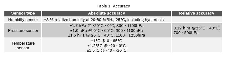

Accuracy
The accuracy represents how accurate the sensor can be under certain condition.
Table 1 lists the accuracy of humidity sensor, pressure sensor, and temperature sensor.

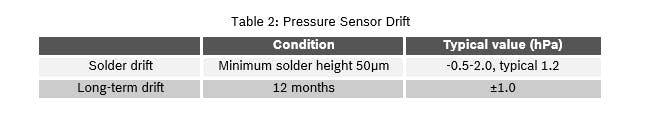

Pressure Sensor Drift
The pressure sensor drift represents the error in the measured value. Basically, there are two drifts on the pressure part in the BME280, i.e. solder drift and long-term drift.

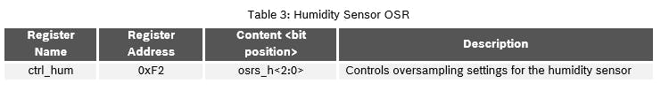

The osrs_h<2:0> settings are explained as follows:
  • b000-> skip humidity data/no humidity
  • b001-> oversamplingx1
  • b010-> oversamplingx2
  • b011-> oversamplingx4
  • b100-> oversamplingx8
b101, and other settings -> oversamplingx16

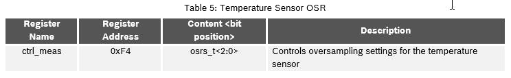

  • The osrs_t<7:5> settings are explained as follows:
    • b101, and other settings-> oversamplingx16
