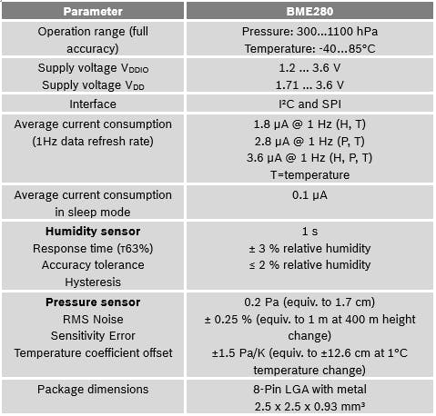

The BME280 series of humidity sensor contains 1 products: BME280. Table 1 shows an overview of the features.
                                                               Table 1: Overview of the products in this family
 Common characteristics
The main characteristics of this product family are:
 Key features
The BME280 is an integrated environmental sensor developed specifically for mobile applications where size and low power consumption are key design constraints. The unit combines individual high linearity, high accuracy sensors for pressure, humidity and temperature in an 8-pin metal-lid 2.5 x 2.5 x 0.93 mm³ LGA package, designed for low current consumption (3.6 μA @1Hz), long term stability and high EMC robustness.
The humidity sensor features an extremely fast response time which supports performance requirements for emerging applications such as context awareness, and high accuracy over a wide temperature range. The pressure sensor is an absolute barometric pressure sensor with features exceptionally high accuracy and resolution at very low noise. The integrated temperature sensor has been optimized for very low noise and high resolution. It is primarily used for temperature compensation of the pressure and humidity sensors, and can also be used for estimating ambient temperature.
The BME280 supports a full suite of operating modes which provide the flexibility to optimize the device for power consumption, resolution and filter performance.

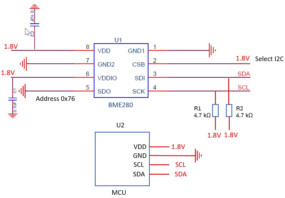

 Reference design
See Figure 1 for a complete schematic of a typical BME280 use-case.
                                                        Fig. 1: Mockup Reference design

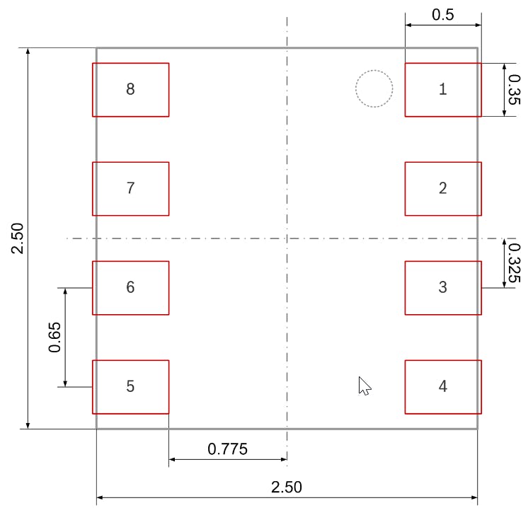

  Landing Pattern
                                                              Fig. 2: Recommended landing pattern
Note: red areas demark exposed PCB metal pads.
In case of a solder mask defined (SMD) PCB process, the land dimensions should be defined by solder mask openings. The underlying metal pads are larger than these openings.
In case of a non solder mask defined (NSMD) PCB process, the land dimensions should be defined in the metal layer. The mask openings are larger than these metal pads.

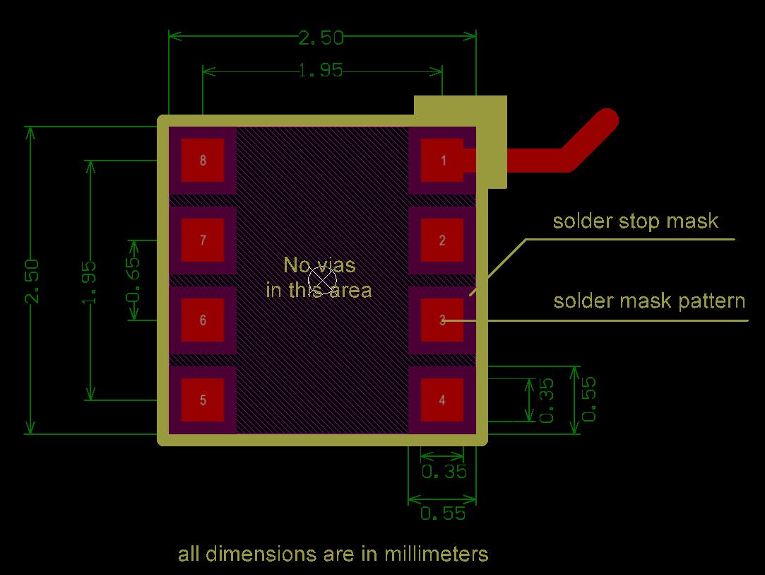

 Typical Layout
                                                                             Figure 3: Typical layout

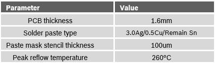

Manufacturing notes
                                                            Table 4: Manufacture recommendation
