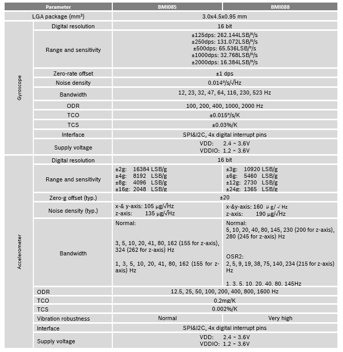

Table 1 shows an overview of the features.
Table 1: Overview of the features

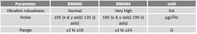

Differences between products
The main differences between the BMI08x family products are the accelerometer part and the overall performance of the MEMS element.
Table 2: Main differences

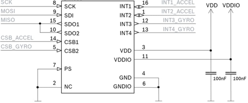

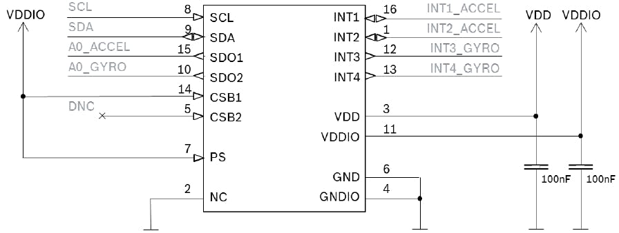

Hardware reference design
Figure 1 and Figure 2 show the I2C and SPI reference designs for BMI085 and BMI088
Figure 1: I2C connection
Figure 2: SPI connection

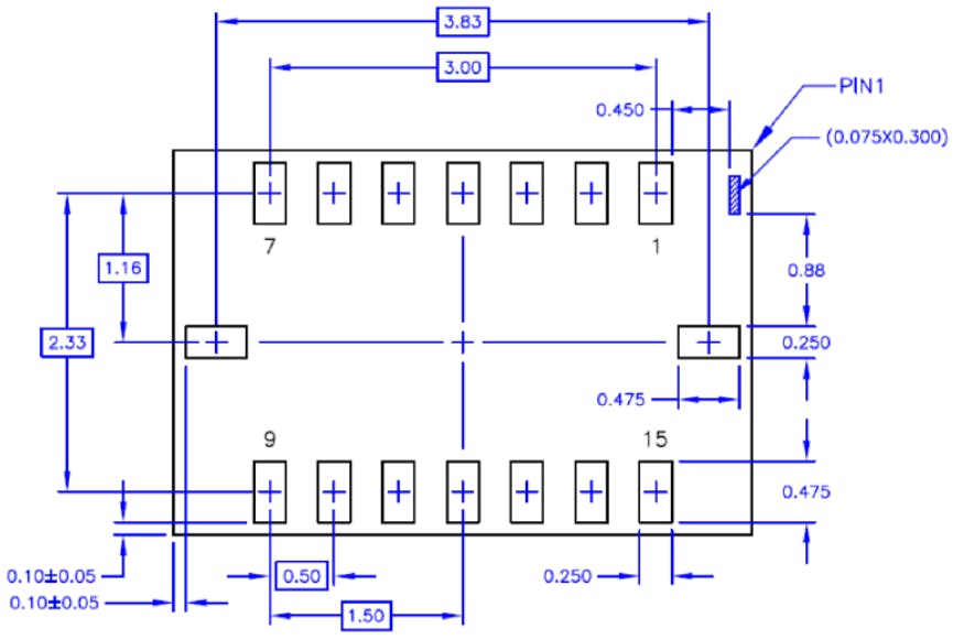

Recommended layout rules
The recommended layout rules are as follows:
- PCB land width = LGA solder pin width
- PCB land length = LGA solder pin length + 0.1mm on each side
- Solder mask opening width = PCB land width + 0.05mm on each side
- Solder mask opening length = PCB land
Landing Pattern
The BMI08x family has the same landing pattern. The following dimensioning is recommended.

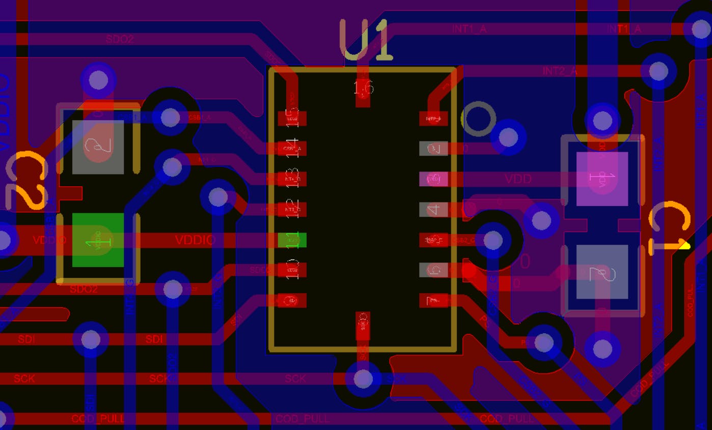

Typical Layout
Figure 4 shows the typical layout.
Figure 4: Typical layout

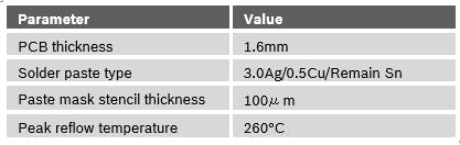

Manufacturing notes
Table 4 lists the recommendations for the manufacture.
Table 4: Manufacture recommendations
