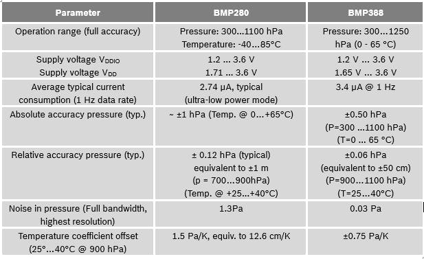

The main differences in the BMP product family are in the thickness of the package, and the overall performance of the MEMS element. BMP388 offers higher performance in a smaller package compared to BMP280. See the complete list of differences in Table 2.
                                          Table 2: Differences between BMP product family members

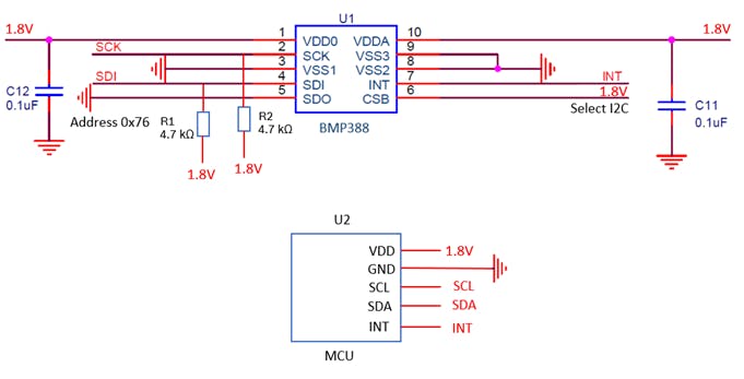

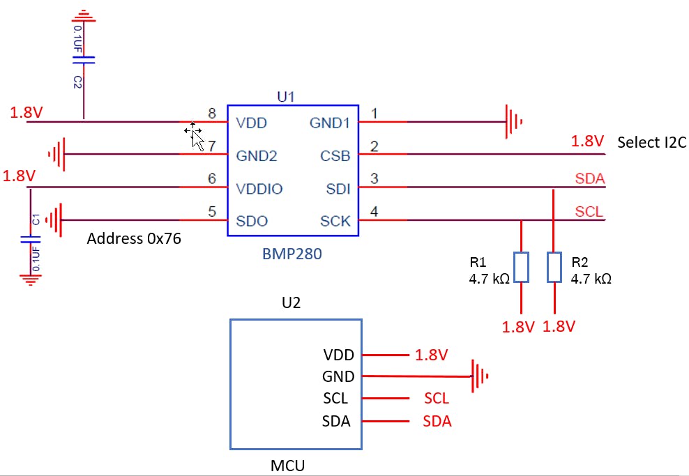

Figure 1 shows a complete schematic of a typical use case.
                                                                                        BMP280
                                                                                       BMP388
                                                       Figure 1: Exemplary Reference design

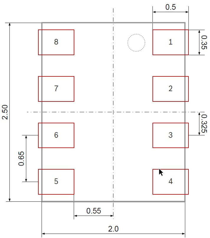

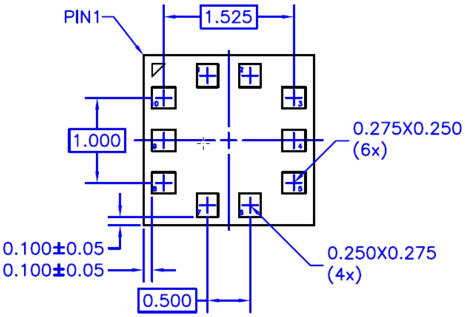

Landing Pattern
                                                                                         BMP280
                                                                                     BMP388
                                                         Figure 2: Recommended landing pattern

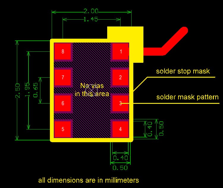

Typical Layout
                                                                                                  BMP280
                                                                                          BMP388
                                                                         Figure 3: Typical layout
