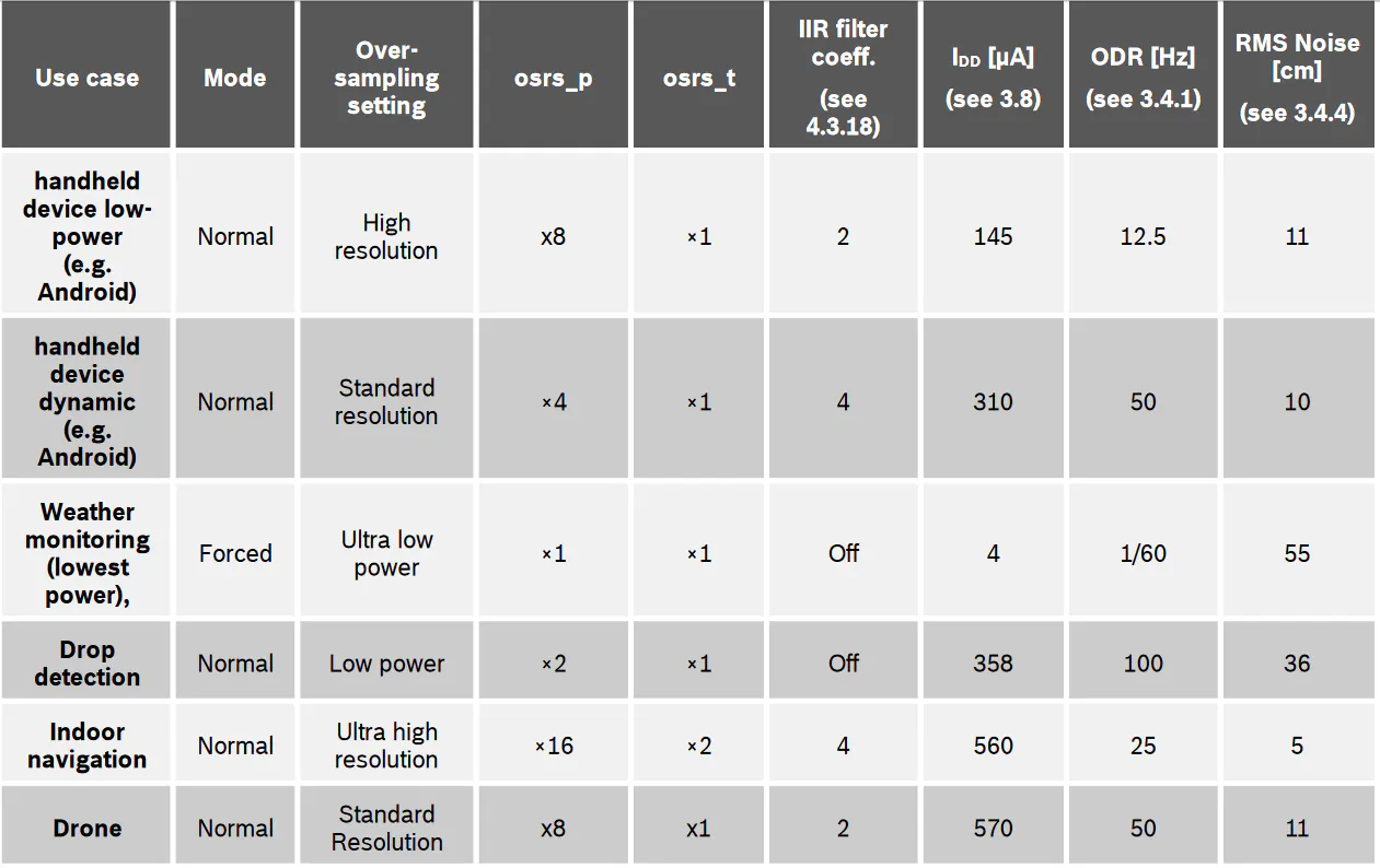

The table below shows the recommended setting of oversampling.

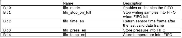

This is a 512 bytes FIFO (first-in-first-out) data buffer with feature used to enable data collecting in the FIFO. The register “FIFO_CONFIG_1” register contains the FIFO frame content configuration from bit 4…0.  The default value for “FIFO_CONFIG_1” is 0x02.
