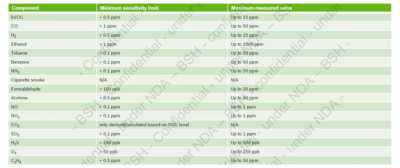

  • Which gases were tested in HQ for BME sensors
DS
Here I listed some gases which were measured by HQ, includes min-max concentration.

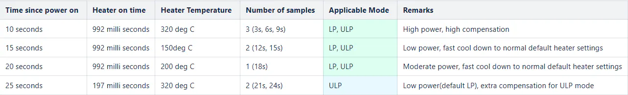

  • What’s the means by ‘burn-in’ and ‘run-in’? and How long time they will take?
DS
‘burn-in’ status means when you get a new sensor, which is a status in the first power-on status, so a sensor only has one ‘burn-in’ status in its life. And in software, we set 0, but it’s recommended to run the sensor for 24h on hardware. Make sure to give the sensor enough time to stabilize.
‘run-in’ status means a status in each power-on status. In software, we set many time about this status which depends on the power mode, here I listed the relation.
Power Mode
Run-in time
LP
5min
ULP
20min
CONT
5min
SCAN
1min
And you can observe the output ‘IAQ-accuracy’, it also shows finishing ‘burn-in’status if ‘iaq-accuracy’ changing from 0 to 1.
The fixed 'run-in' time only existed before BSEC 2.5.0.2 version, after that we have run in profiles to speed up the period for BME688 and BME690, why we do that is fixed time will cause some risks about s-t-s deviation.
However, 'run-in' time is still influenced by the last power-off time, here I list an example of 30mins power-off time for BME690 based on BSEC 3.2.1.0:
LP: ~2mins   ULP: ~10mins

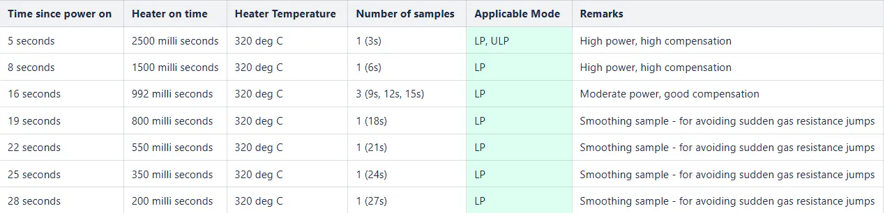

  • New Run-in conditioning for LP & ULP mode.
DS
  • BME690 in BSEC 3.2.1.0
  • BME688 in BSEC 2.6.1.0 and BSEC 3.2.1.0
