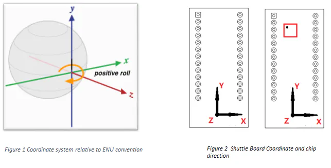

Accelerometer (Acc), Gyroscope (Gyro) and Magnetometer (Mag) sensors (components) have their own coordinates. By default BHA and BHI are configured to ENU axis convention (East-North-Up), as commonly used in consumer electronic devices. It is usually obtained by the integration of Accelerometer (Acc), Gyroscope (Gyro) and Magnetometer (Mag) sensors readings.
The ENU coordinate system is defined as a direct orthonormal basis where:
    x points east and is tangential to the ground.
    y points north and is tangential to the ground.
    z points towards the sky and is perpendicular to the ground.
 Users can download the BHI/BHA firmware from Bosch Sensortec Website. All firmware’s coordinates are the same. Figure 2(left) shows the coordinate of the BHI/BHA shuttle board. Cares must be taken that the direction of BHI/BHA and Magnetometer sensor must follow the BHI/BHA shuttle board when customer do the PCB placement. Figure 2(right) shows the direction of BHI/BHA and Magnetometer on the shuttle board.
It is the easiest and best way that customer can reuse the same coordinate of BHI/BHA shuttle board on their product. It is possible to change the coordinate based on customer definition. This document is to tell the customer the way how to do the axis-remapping on their products.
