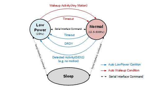

Concept of auto-wakeup & auto-low power

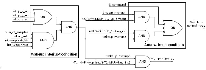

Auto Wakeup
As shown in the diagram, the wakeup function can generate an interrupt by detecting defined movement, while the auto-wakeup function can switch the BMA400 from low power mode to normal mode. During switching to normal mode, the sensor configurations defined in previous normal mode (before entering low power mode), like ODR, range, OSR, FIFO, interrupts, will be restored automatically. Therefore, the host only need to configure BMA400 once in initialization and no need to reconfigure the parameters after BMA400 enters normal mode by auto-wakeup function.
The three possible triggers for wake-up from low-power mode are:
- by serial command
- by timeout
- by wake-up interrupt on activity
The three conditions can be enabled in parallel.
Please be notified that, the timeout wakeup can only switching BMA400 to normal mode if configured, and cannot be mapped to the interrupt pin(INT1 and INT2).

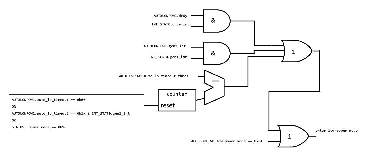

Auto Low Power
Except the serial command, there are three possible triggers can switch BMA400 to low-power automatically:
- by timeout
- by activity on Gen1(Gen1 interrupt will trigger the switching to low-power mode)
- by data ready (DRDY)
Also in timeout mode, the counter can be reset by interrupt from Gen2 interrupt. This can be used to enlarge the active time (in normal mode) of BMA400 if some activity is detected by Gen2.

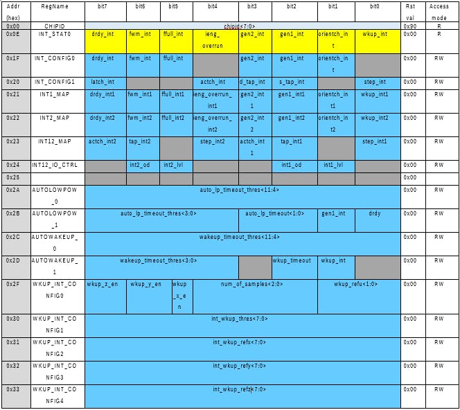

Relative registers

Parameters configure
In this example, range = 2g, ODR=100Hz, Accel data source = filter1
Auto-lowpower relative
Register(0x2A),Register(0x2B):
auto_lp_timeout_thres = 400 (400 * 2.5ms = 1s), unsigned 12bit, timeout threshold, 2.5ms/lsb

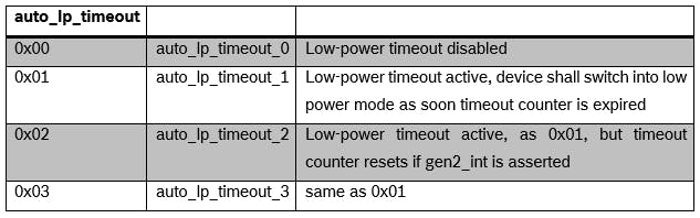

auto_lp_timeout: set to 1 here (enable), timeout as source for auto-low-power condition
For mode auto_lp_timeout = 0x02, gen2 interrupt will reset the timeout counter, and this can be used to delay the auto-lowpower if some condition is fulfilled. For example, in watch/band, gen2 can be configured to detect the body movement, and only if no movement is detected, the timeout counter will be continued and after defined time, the sensor eventually goes into low power mode.
Auto-wakeup relative
wakeup_timeout_thres = 0x0FFF (max value, 0x0fff * 2.5ms = 10.24s)
Register (0x2C) and (0x2D), unsigned 12bits, auto-wakeup timeout threshold, 2.5ms/lsb
wkup_timeout: set to 1 (enable)
Register (0x2D) AUTOWAKEUP_1. wkup_timeout = 1; enable timerout triggering auto-wakeup

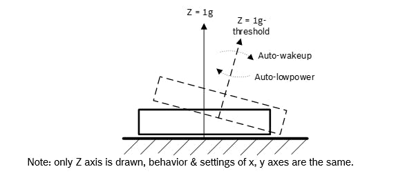

Auto wakeup and auto low power by position
Case description
In this example, the wakeup interrupt is defined to detect the non-flat position of the sensor. A threshold (94mg) is configured, so if the sensor tilt over the threshold, the wakeup interrupt will be set and switch the BMA400 to normal mode(auto-wakeup function).
Once entered into normal mode, the Gen1 will continuously detect the sensor position, and check if the sensor returns back into the range of flat, this range should be smaller than 94mg(here gen1 threshold is set to 40mg). So, once the gen1 condition is fulfilled, BMA400 will automatically switch to low power mode by auto-lowpower function.
wkup_int = 1; use wake-up interrupt for auto-wake-up
Wakeup interrupt relative
Register (0x2F) WKUP_INT_CONFIG0
wkup_x_en, wkup_y_en, wkup_z_en = 1; enable three axes
num_of_samples = 3; 4(=3+1) continuous samples will be monitored in low power mode
wkup_refu = 0; manual update, configured by host
Register (0x30) WKUP_INT_CONFIG1
int_wkup_thres = 3; (3 * 1/32 * 1g = 94mg) @4g range, range sensitive, 8 bit unsigned value
Register (0x31) WKUP_INT_CONFIG2 to Register (0x33) WKUP_INT_CONFIG4
int_wkup_refx/y/z = (0, 0, 32); (0, 0, 1g) @4g range, range sensitive
So the wakeup interrupt will be set only if:
Condition 1: (|acc_x - ref_x| > 94mg) OR (|acc_y - ref_y| > 94mg) OR (|acc_z - ref_z| > 94mg)
Condition 2: more than 4 continuous past samples fulfill condition 1

Auto wakeup and auto low power by activity
Case description
This example is suitable for activity detection, where the device (sensor) is not placed into a fixed position, like wearable devices. To achieve this, Gen1 can be used to detect status that the sensor is in stable status, like the user wearing the device is in sleep, standstill, and trigger the Auto-Lowpower to switch BMA400 into low power mode; in contrary, the auto-wakeup function can be configured to detect the activity, and wake the sensor into normal mode.
The key differences between the implementation of actvity detecting(this example) and position detecting (example described in chapter 4.2), is the reference update mode and the relative threshold and number of samples. For activity detection, the reference update mode of wakeup & Gen1 functions should be configured as everytime which means every sample of acceleration will be taken as the reference of the coming wakeup & Gen1 calculation, so the reference will be updated continuously and regardless of any fixed position(as described in chapter 4.2).
Range = 4g, ODR=100, OSR=1
Register (0x2B) AUTOLOWPOW_1.gen1_int = 1; set this bit the interrupt from Gen1 will trigger the switching from normal mode to low power mode
Generic interrupt 1 (gen1) relative
Register (0x3F) GEN1INT_CONFIG0:
Set gen1_act_x_en, gen1_act_y_en, gen1_act_z_en = 1 (enable all 3 axes)
gen1_data_src=1; select filter2 (fixed 100Hz) as data source
gen1_act_refu = 2; everytime (every time automatically updated from the selected filter data)
gen1_act_hyst = 0; disable
Register (0x40) GEN1INT_CONFIG1:
gen1_comb_sel = 1; logic AND
gen1_criterion_sel = 0; inactivity interrupt
This combination means that ALL (logic AND) three axes value should be WITHIN (inactivity interrupt) the threshold near the reference position.
Register (0x41) GEN1INT_CONFIG2:
gen1_int_thres = 5 (threshold = 5*8mg/lsb = 40mg)
Register (0x42) GEN1INT_CONFIG3/Register (0x43) GEN1INT_CONFIG31
gen1_int_dur = 100 (monitor duration = 100samples * 1/100Hz(filter2) = 1s)
Register (0x44) GEN1INT_CONFIG4 to Register (0x49) GEN1INT_CONFIG9:
gen1_int_th_refx/y/z, no need to configure, if reference update mode is everytime
So in this configuration gen1 interrupt will be set only if:
Condition 1: (|a_x_current - ref_x_last| < 40mg) AND (|a_y_current - ref_y_last | < 40mg)
AND (|a_z_current - ref_z_last| < 40mg)
Condition 2: more than 100 continuous past samples fulfill condition 1
wkup_int = 1; use wake-up interrupt for auto-wake-up(switch BMA400 to normal)
num_of_samples = 3; 4(=3+1) continuous samples will be monitored in low power mode; the less the samples, the more sensitive the wakeup detecting
wkup_refu = 2; everytime update
The smaller the threshold, the more sensitive the wakeup detecting
int_wkup_refx/y/z no need to configure if update mode is everytime
Condition 1: (|acc_x_current - ref_x_last| > 94mg) OR (|acc_y_current - ref_y_last| > 94mg)
OR (|acc_z_current - ref_z_last| > 94mg)
