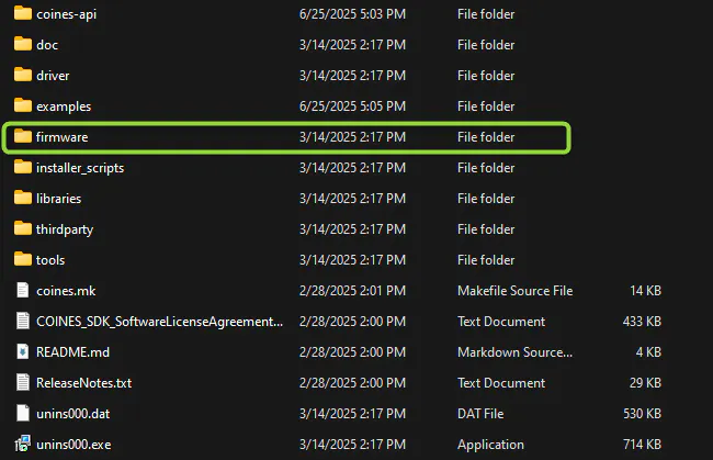

After installing you should see this folder:
Select the used board can flash all the firmware, the bat scripts had been included in them:
Press the button 2 when flashing if meet any issues about flashing works (make sure the led will change to 'blue' when flashing)
