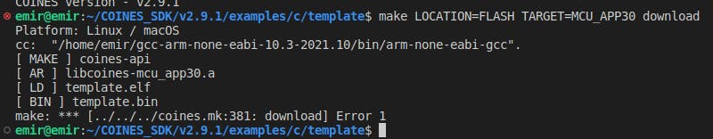

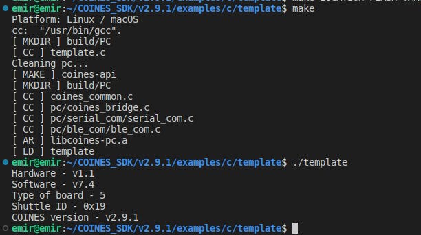

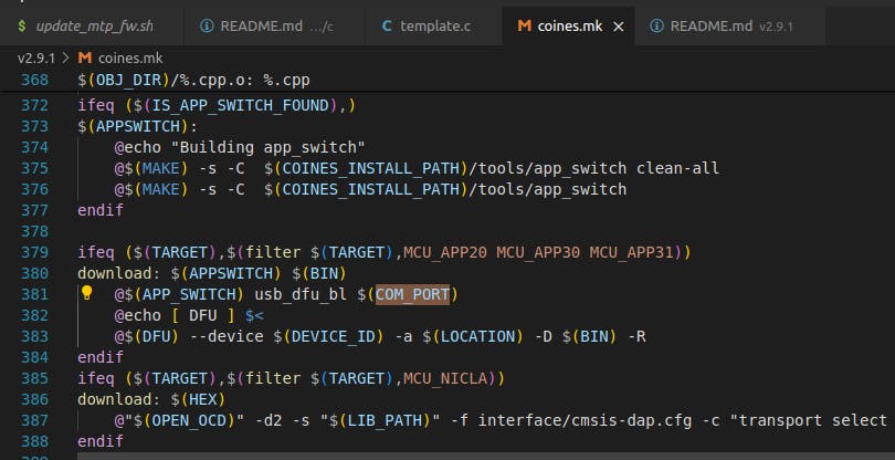

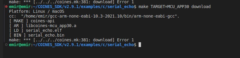

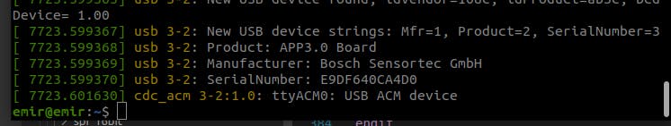

I have Bosch Application Board 3.0 and BNO055 IMU sensor. I am using Ubuntu 22.04. I installed the COINES SDK as the latest version from the official Bosch github. I installed the necessary dependencies. I connected it to my PC via USB and the port is shown as ttyACM0. I installed libusb-dev dbus-devel. It works when I compile it as target pc, but when I compile it as MCU_APP30, I get an appswitch error, can you help? and I want to listen to the data in imum with serail echo in the examples, but I still cannot build on the MCU. I have added the necessary screenshots below.
