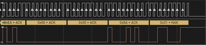

I am currently using Max78000 to interface with BHI160, I am using a 1.8 V supply to power the Sensor, and I am operating the system clock at 60MHz.
when I tried to use the read the FIFO, it gets into a hanging state( It makes my SCL to a Low state forever), I am currently using my i2c clock 400kHz.
I have Disabled the I2C Clock stretching and tried but the result is the same, I am attaching pictures for reference.
The 1st picture is the captured hanging state in the Logic analyzer.

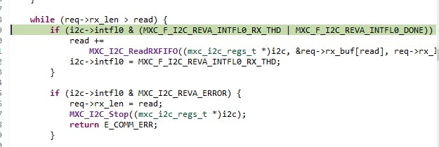

The 2nd picture is the code snippet where I am stuck.

Thanks, BSTRobin
We managed to get it worked with some modifications done with I2C Driver.
