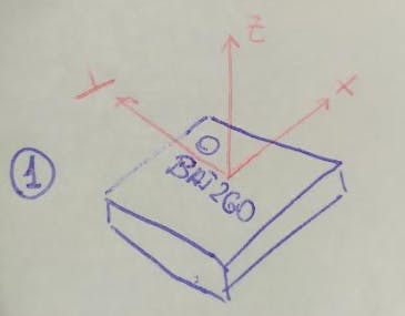

So, I have the BHI chip with the following references (in red):

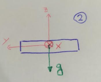

Then we have the gravity:

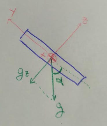

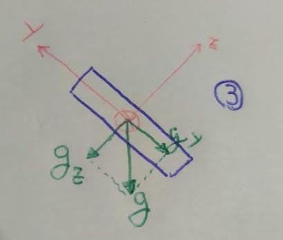

Then when the chip has a certain inclination:
In this picture, gravity has just two components (YZ) because the drawing shows a rotation around the X-axis (it's easier for me to draw this 2D scheme). But let's assume that the chip can have any orientation and the gravity is decomposed into the three axes.

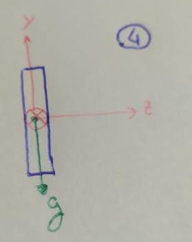

On my project, I have an initial position of the device which is when the BHI chip is in the following orientation:
This orientation is considered to be the 0° inclination. And the inclination angle is calculated by doing the following:
alfa = arcsin(gz / g);
Where gz is the module of the Z component of the gravity and g is the module of the gravity.
So I do that calculation with my STM32 and I was surprised when I placed the device in the initial position (picture 4). My alfa angle was showing of inclination. I was expecting the angle not to be 0°, but not to have such an error in the initial position.
Inspecting the g components got from the BHI chip in the initial position I got the following:
x = 0.017333984375 g
y = -0.992431640625 g
z = 0.120361328125 g
I'm very surprised by the Z component. It should be very low, but it's not.
