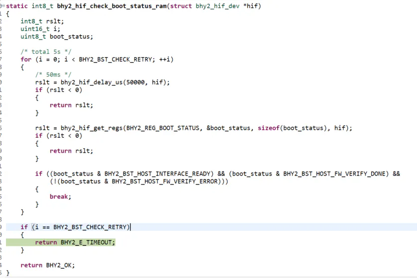

But unfortunately, after successfully transferring the firmware over SPI, the boot from RAM process fails. More specifically, the API function bhy2_hif_check_boot_status_ram() times out.
Checking the register 0x25 (Boot Status register), the value is 0b01111000. Where the bit6 is Firmware Verify Error. So the firmware verification is throwing an error.
