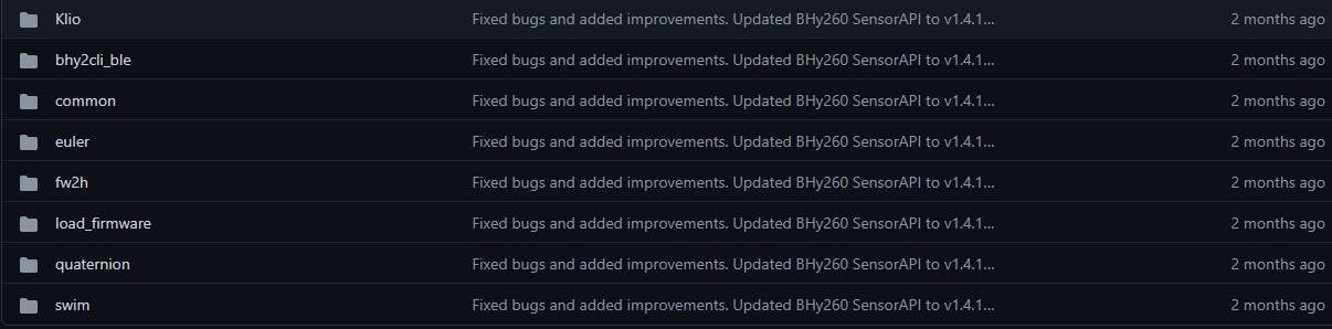

6.I understand files such as Euler and Quaternion among example files, but what does 'Klio' file mean?

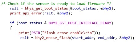

One more thing, if you look at all the applications in the example, after booting,
As shown in , the contents of unconditionally erasing and writing flash are all the same.
In general, I understand that writing on flash only needs to be done once.
I don't understand why the example source is configured this way.
