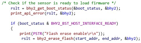

One more thing, if you look at all the applications in the example, after booting up, you can see that.
Like this, the contents of unconditionally erasing and writing flash are all the same.
Normally, I only need to use it once for flash.
I don't understand why the example source is configured this way.
