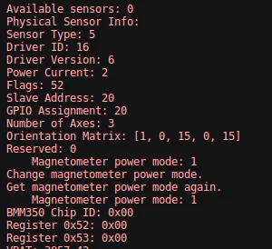

Hello, I Have BHI360 paired with BMM350 using I2C on pads ASCX, ASDX, and JTAG_DIO connected to interrupt. I2C is pulled-up to 1V8. Im trying to read magnetometer data but without success so far. Im not sure what steps should be taken to achieve this. So far i uploaded firmware to BHI360 (Bosch_Shuttle3_BHI360_BMM350C.fw but i tried with a few other). Now im trying to read some data from BMM350 to confirm that hardware is working. Using bhy_system_param_get_physical_sensor_info i got these values:
i also tired to read its registers using soft passthrough, but i always get 0x0 as response.
