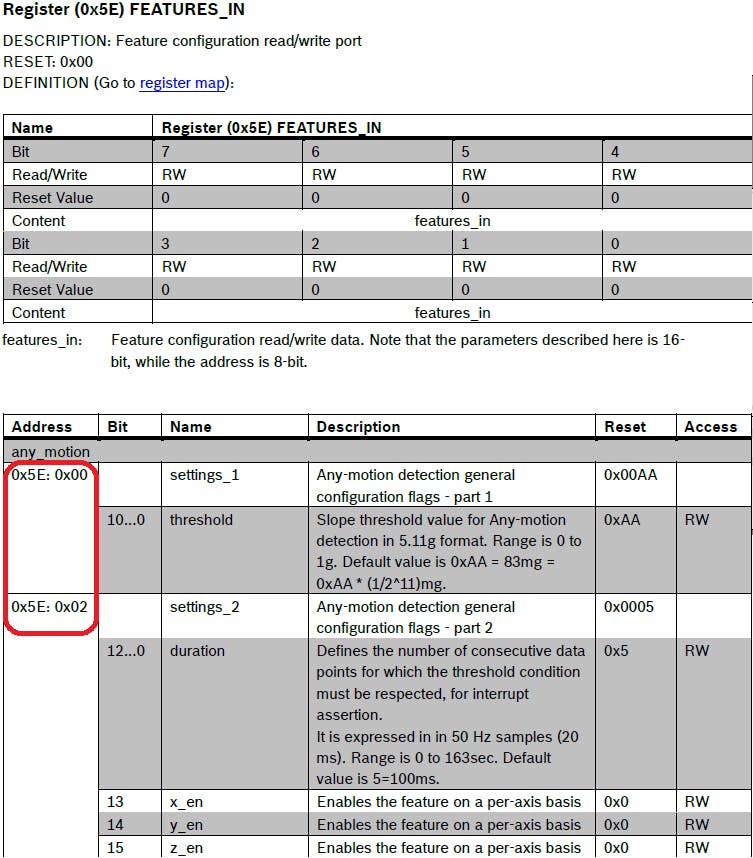

I'm going to use bma455 for this project, but it's completely different from the BMA253 I used the other day, so I'm going to ask about this part.
My problem is the register address of the Interrupt part.
When i try to use the Anymotion function, the Register part is checked with two Addresses like picture.(Picture is bma456 application note file)
So I want to know the Sequence of Anymotion Interrupt Register input of bma455. It is possible to inform you by using a similar bma456 sensor, not the order of bma455.
Please Guide me
