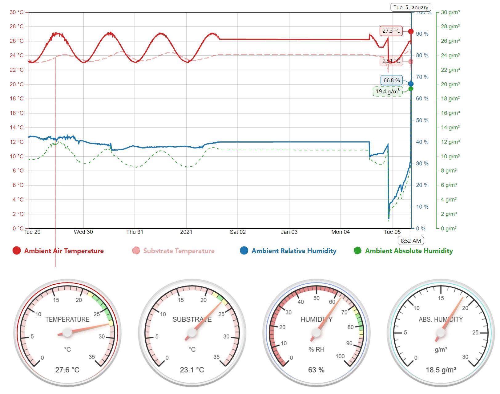

About 8 months ago, I noted that the RH was reading way lower than I had expected, but had assumed that it was correct.  I changed out the sensor, and the readings went straight back to what I thought it should be.  Last week, I noticed the issue again, but this time I had it trended.  Unfortunately, it is still outside the history range (to the the left of the graph), but what happened was that the humidity plummeted on a step change from about 70% down to 40% and consistently read 30% low from then on. This can be seen as it hovers around 40% in the graph below. (the straigh horizontal lines were a loss of data connection)  There was no obvious reason for the step change.
I shut down the system down last night and restarted it to get the first vertical line step change seen on the right of the graph, from 40% down to near 10%, which climbed over night to about 35% (about half of what it really is). With this poor performance, I swapped this sensor out with the original sensor that malfunctioned about 6 months ago, and the readings popped right back up to where it should be.
So what is happening here?  The sensor is mechanically protected, all the connections are heat shrunk and terminated properly. The only abnormal thing is that the sensor is in a relatively high humidity environment constantly.  Am I operating the sensor out it's specification or what?
