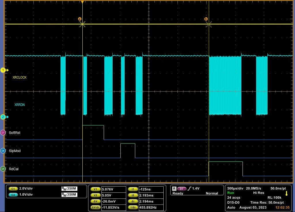

Using an oscilloscope, the start-up timing for two situations is measured, one with reading correct calibration data (Figure 1) and one with incorrect calibration data (Figure 2). Logic analyzer signals were added in the code to indicate the start of a task (soft reset, set Sleep mode and reading calibration data). The I2C clock was measured to indicate the communication process.
Figure 1: Correct reading of calibration values
From Figure 1 it can be noticed the time between start of the Soft Reset (SoftRst) and start of reading calibration data (signal RdCal) is ~2.2msec. The blue signal is the I2C SCL clock. We do get the following calibration values:

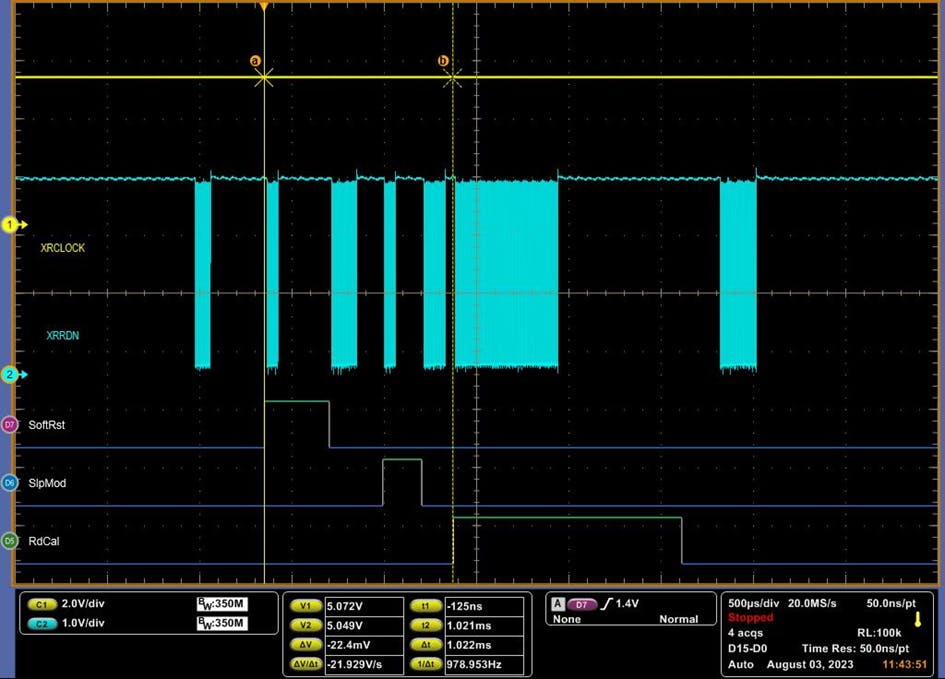

Figure 2: Incorrect reading of calibration values
From Figure 2 it can be noticed that the timing between starting the Soft Reset (signal SoftRst) and start of reading calibration data (signal RdCal) is much shorter (~1 msec) compared with the timing shown in Figure 1.
This results into incorrect calibration values as shown below.
