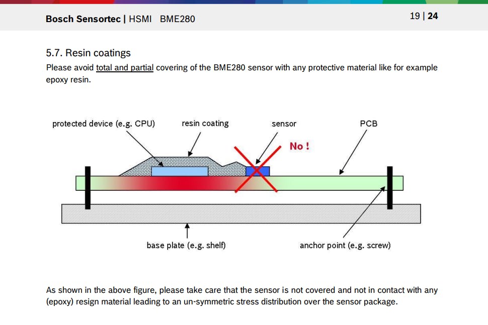

We want to protect electrical connections from the environment, without breaking "Handling, soldering & mounting instructions" (https://www.bosch-sensortec.com/media/boschsensortec/downloads/handling_soldering_mounting_instructions/bst-bme280-hs006.pdf), of course with port protection.

Please see below comment for reference,
1, As the description from BME280 HSMI document, we don't recommend total and partial covering the sensor.
  • If you want to under fill the sensor with gel, should protect the air hole on the sensor surface and keep no gel into the sensor
  • The performance of the sensor will be influenced with under fill gel
2, Based on the HSMI chapter5.1
  • If you can use membrane to protect the sensor and pad
  • If your equipment structure available, you can reference the design from chapter5.1
