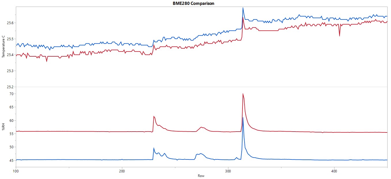

I have a pair of BME280's on Adafruit breakout boards, running side by side in open air reading ~10%RH apart.
Is this issue likely to be fixable by going through the reconditioning procedure or is the discrepancy too large and indicative of damage?
Both sensors are set to the same filtering/averaging, and are read out via an Arduino.
Both sensors have had pins soldered to their breakout board adhering to the soldering instructions, then left for 5+ days at 25C/40%RH to settle.
The sensors are from different lot numbers (736 and 672)
