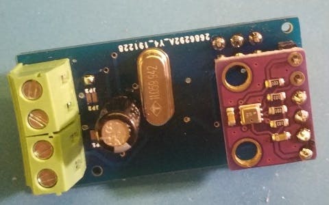

Is it possible to measure real temperature with bme280 without power off sensor between measurements? Is it issue with my board or it is by design?
As sensor i use small board with bme280 sensor from aliexpress. I connect sensol to microcontroller by I2C. И usе original bosh driver and 2 samples/minute. I have 10 sensors, all of them show +0.7-1.2 C in 10 minutes after start.  Board with sensor:
No matter how to place board with sensor in space. I tried to put sensor at bottom to avoid heating from microcontroller. I don't see correlation between wrong mearurements and heating sensor orientation in space.
Some logs:
Power on sensor and start measurements. I see + ~1.1C in 10 minutes.
Power off, wait for 10-15 minutes. I see the same data on start and + 1.1C in 10 minutes.
