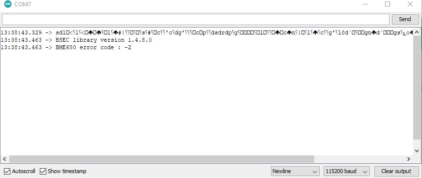

"BME680 error code : -2" using the basic example of the BSEC Library on a NodeMcu ESP8266
I followed the guide as per https://github.com/BoschSensortec/BSEC-Arduino-library
Compiling and Uploading the example code on the ESP8266 does work, but I get this Error:
I connected the BME680 via I²C, and other third party codes do work, but I need this one to work tho.

Have you already tried to change the address from primary to secondary?
For example:
iaqSensor.begin(BME680_I2C_ADDR_SECONDARY, Wire);
Let me know
