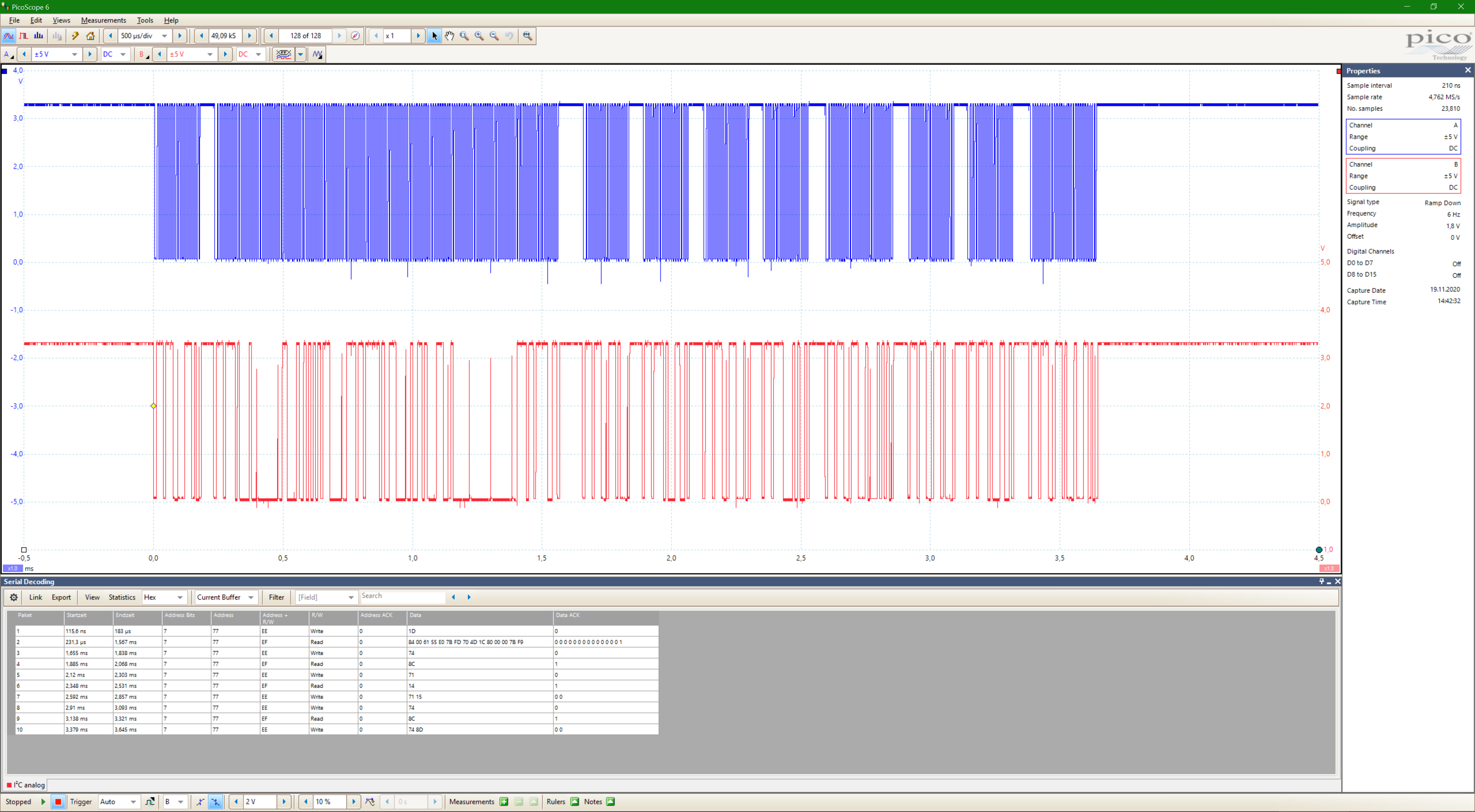

Here comes my problem: Normally, that configuration works fine. I have tested it with a BME680 on a Joy-It breakout board connected directly to a Raspi 3 via I²C at 3.3 V, and it runs flawlessly for days. I have recorded a communication cycle with an oscilloscope; see Scope_regular.png

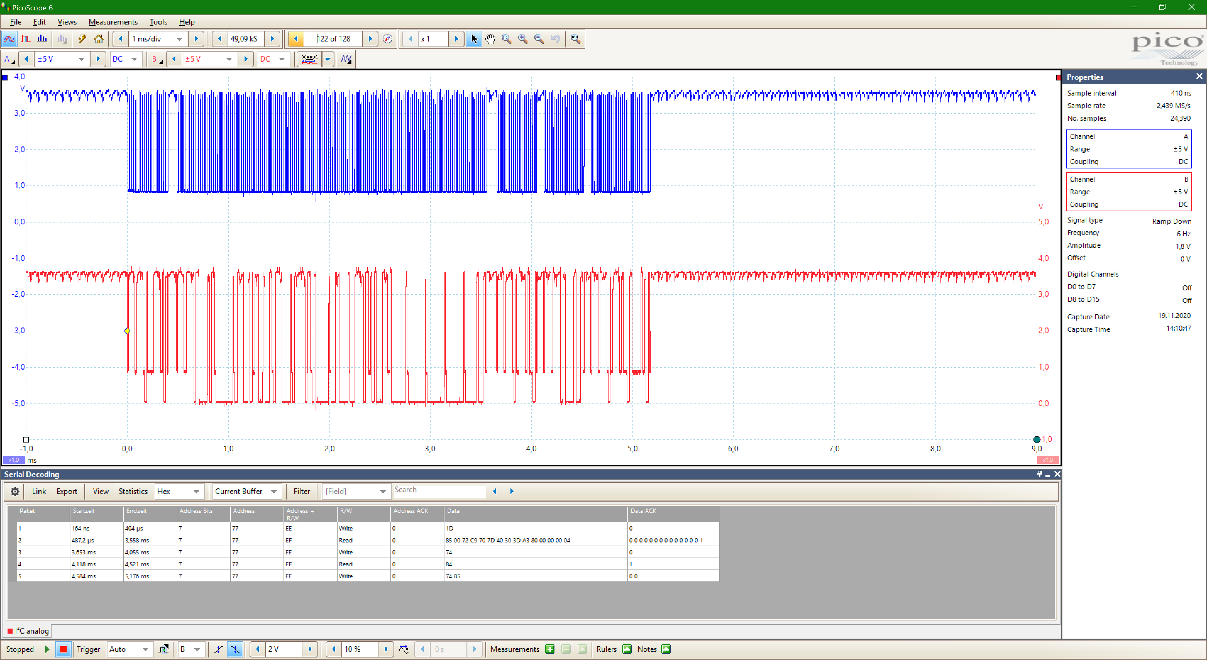

In my lab setup driven by a Odroid C2, however, there are three of those BME680 boards connected to the I²C via a TCA9548A multiplexer and P82B96 line buffers with a supply voltage of 3.6 V. They may run equally flawlessly for up to a day, but after some (possibly shorter) time any one of them can get into an error state in which it is unable to achieve a stable heater temperature. Once it occurs, that always affects all ten temperature steps, whereas that sensor's other measurements (ambient temperature, pressure, humidity) continue to work fine. I have captured a communication cycle in the error state as well; see Scope_long.png
How to stabilize the heater? Do I have to use longer cycles? It does not seem to depend on ambient temperature, as it usually happens at room temperature.
