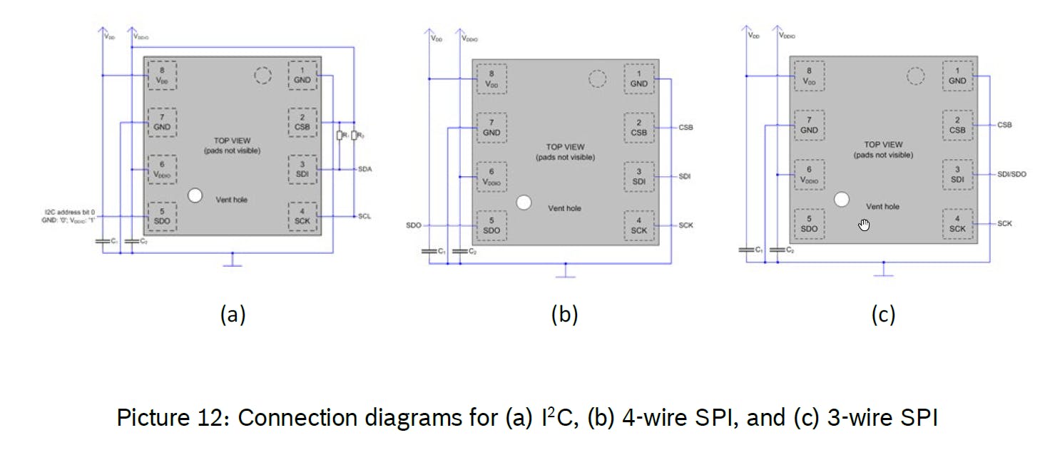

Hello baqwas,
There was SPI or I2C connection reference schematic in BME680 datasheet.
You could connect your host SPI or interface(from Raspberry Pi board) to BME680 SPI or I2C pins.
