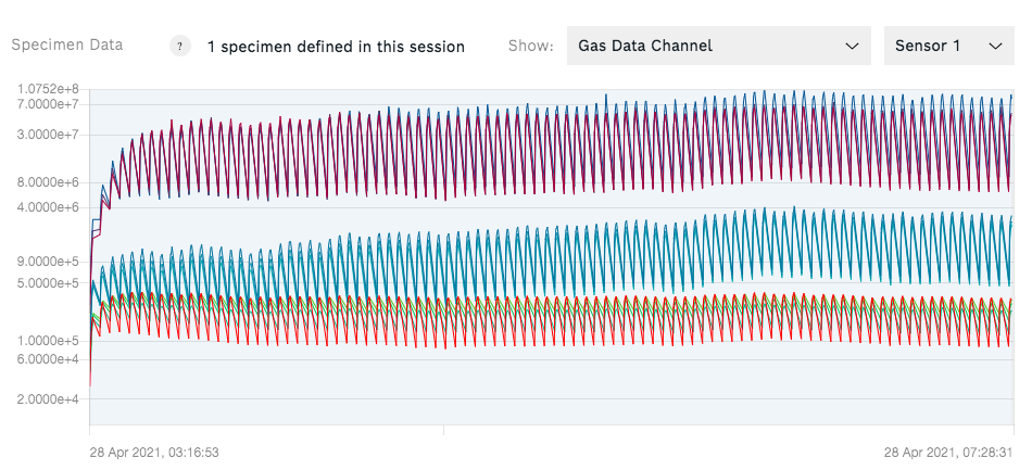

What do the various traces on the AI studio Gas Data Channel represent?
Thank you.

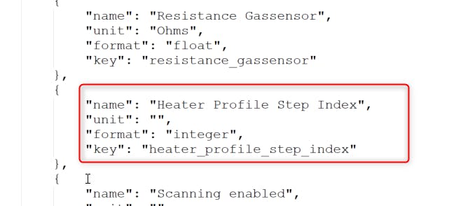

Hello avfe,
There are 12 columns in datablock in datalog file in SD card, there is a column for heating step index(0-9) as below to show the heating step.
