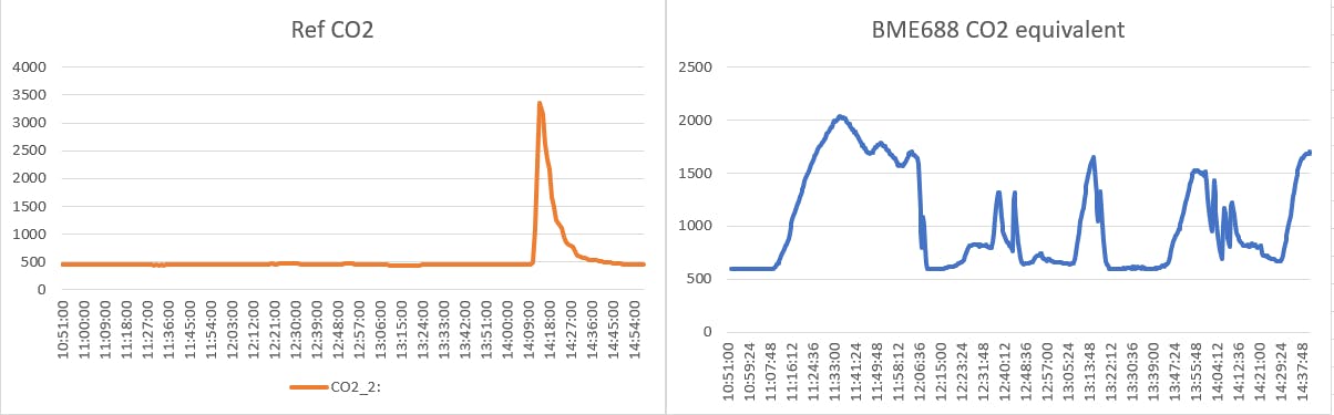

To simulate people in the sauna, I use a CO2 cannister from which I release some gas from time to time.

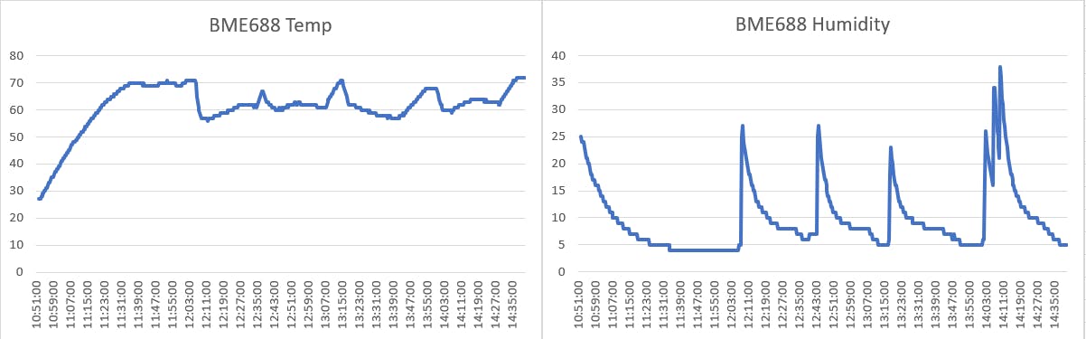

Right now the CO2 equivalent I am measuring with the BME688 seems totally off and very much influenced by the temperature and humidity. I do not see any correlation with the actual CO2 level that I am measuring with my other sensor.
I add some graphs of some measurements I have been doing.

- How sensitive to temperature and humidity is the BME688 sensor?
- Can we measure pure CO2 with this sensor? Or does the CO2 equivalent is calculated from human breath only?
