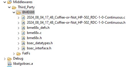

I have added the bme68x, datatypes and interface to the firmware, and include these in the build, along with the libalgobsec.a file, which is also compiled into the firmware:
Additionally I have the 'coffee or not' example from the AI studio examples. Right now I can read appropriate temperature, humudity and air pressure data. What I am unsure of is how to feed the BME688 the 'coffee or not' configuration array.

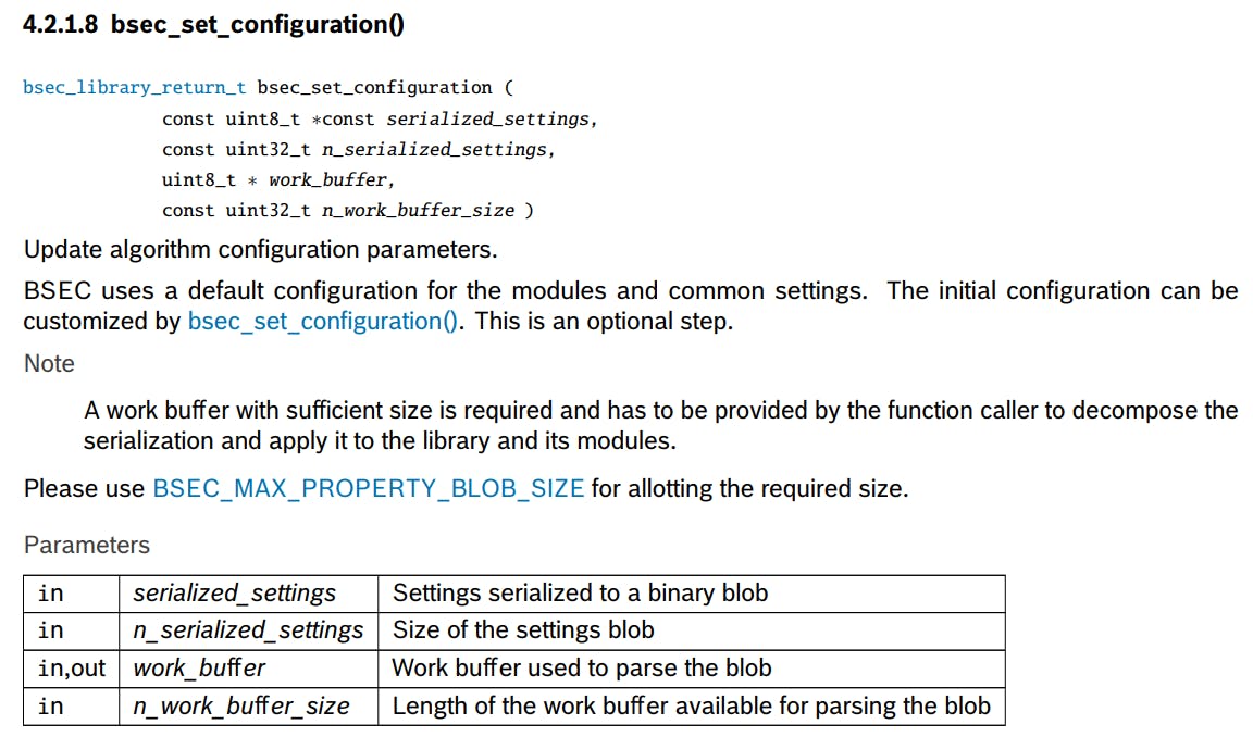

Question 1: Configuration Array
Is this configuration array generated by the AI studio (in my case, the coffee example) the array that is provided to the bse_set_configuration function as the serialized_settings paramter?
If not, how is the config array provided to the BSEC library?
