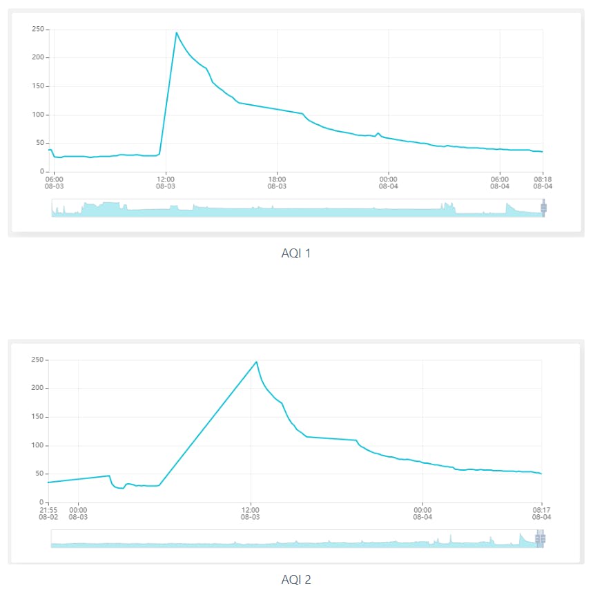

We have been testing several different sensors and I’m getting some strange results. The process to come to this was the following
- Inserted 2 calibrated modules into a hermetic box.
- The environment was contaminated with a source of controlled combustion (small fire producing smoke).
- Allow a few minutes for it to generate peak readings.
- Both sensors are removed from the box and returned to a "clean" environment.
- Wait for the readings to drop.
As shown in the graphs below, that’s the type of response we are getting with a 10 minutes update. A steep climb and a very slow drop that doesn’t reach initial value even when exposed to external clean air.
The readings drop, however, very slowly and do not return to the original value even after a lapse of 20 hours.

Hi ANick,
After readings drop, it's normal that IAQ value is different from the original value. Because IAQ value is relative, not absolute. For example the config_file_4d or config_file_28d which from BSEC generic released package, BSEC will consider the before 4 or 28 days as a reference to count the baseline which is used for calculating the IAQ value, as if you used 4 days-config_file, the peak value will be involved in calculating the baseline, so the subsequent measurements for 'clean air' will be higher than the original value.
