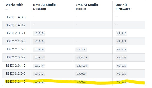

I have the versions installed as highlighted in below picture.
In BME AI-studio I did "export for BSEC 3.2.1.0" from my algorithm and placed all the exported files on the SD card (including .aiconfig, .config).
The .bmeconfig configuration file is exported from the BME AI-studio v3.1.0 with default profile setting.
I used the devkit firmware "devkitfw_v2-1-5_website_release" to flash the board, but the release notes says something else about the different versions than in the above picture. I guess the release note is not updated for the latest versions and the information here is incorrect.
