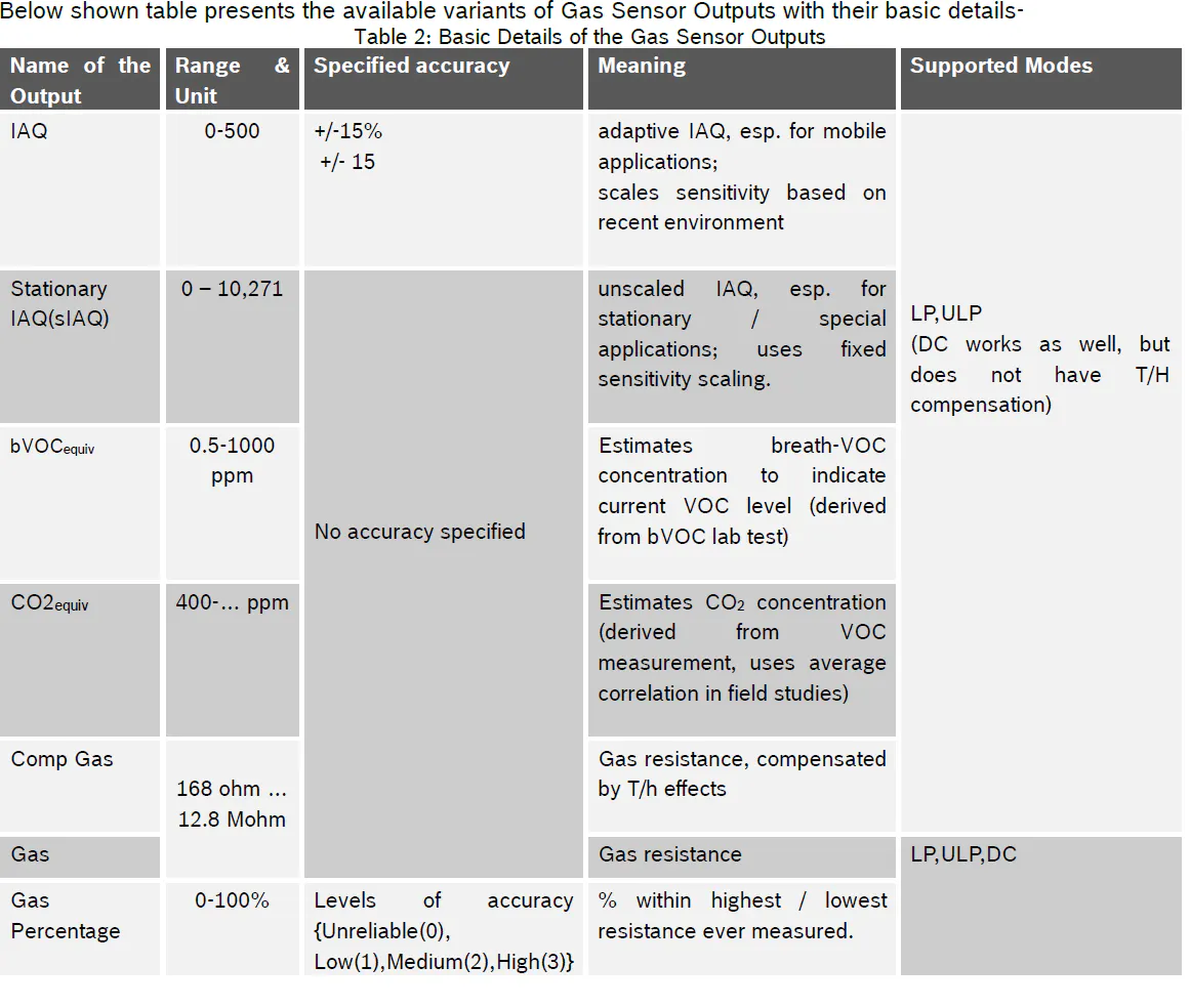

Hello fabian_ch,
1.BME688 can distinguish fresh air and ethanol, however we did not tests between acetone and ethanol;
2.For the concentration of gas, we do not guarantee the accuracy, there is no resolution for it as well, please refer to below table.
