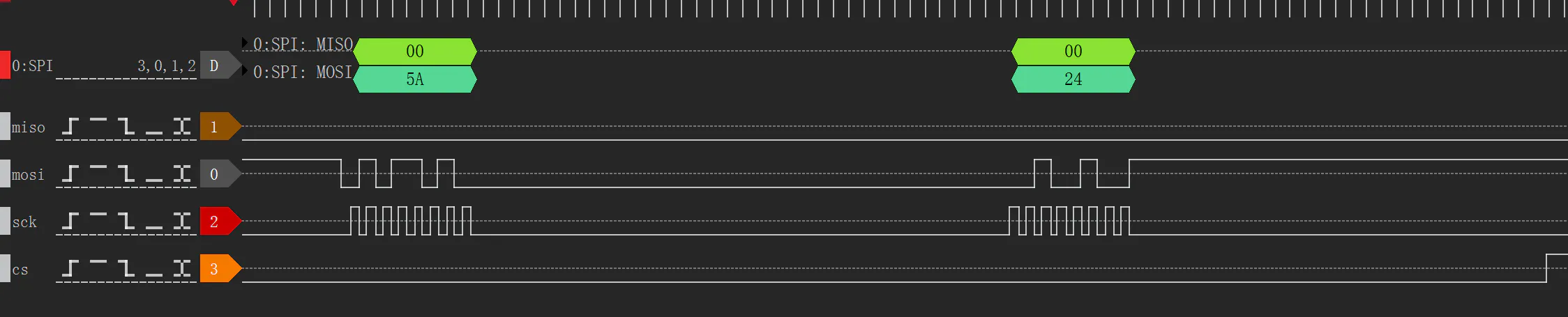

 and I found that data[0].idac == 0, it mean that no heater,
so write the reg 0x5A for a value , and then read it out, the register 0x5A is still 0x00
the timing waveform is correct, so what can I do?
