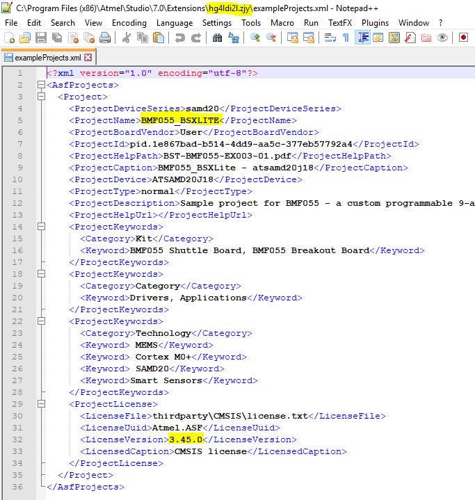

If you have successfully installed the BMF055 Example Project - BSX Lite Integration extension in Atmel Studio, I found that a possible workaround consists of manually upgrading the ASF depency of the extension:

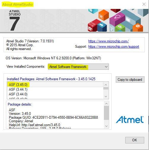

  • In Atmel Studio, find the current latest version of ASF installed. For me it is currently ASF 3.45.0 (see this snippet from the Help->About Atmel Studio window).
  • Close Atmel Studio
  • Find where your extension was installed. For me, it was under "C:\Program Files (x86)\Atmel\Studio\7.0\Extensions\hg4ldi2l.zjy".
  • Open "exampleProjects.xml" and find the "LicenseVersion" element. Replace the default value with your current ASF version (we need 3.45.0 in this example).
  • Open Atmel Studio again. When creating a New Example Project from the BMF055_BSXLite extension, you should now be prompted with the Software License Agreement pop-up window and be able to run the example project.
