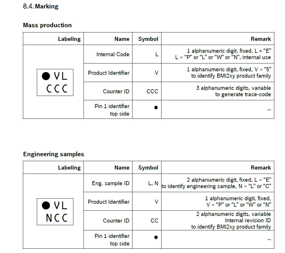

I have stange issues with my BMI270. The first is that its chip ID is different than the expected one (0x26 instead of 0x24) and once changed in my code in order to continue configure it, so when all finished the Internal status return 3 (invalid driver)!!

You could see it from BMI270 data sheet that it does not comply with the marking specification of BMI270.
