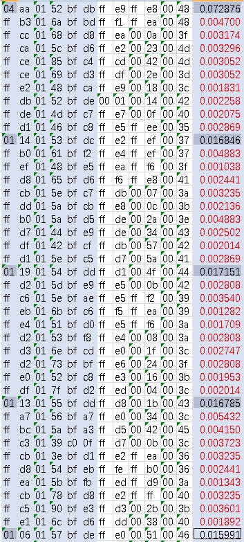

Issue 1: there some regular value jumps in 10Hz
Raw Acc. value
Regular jumps in 10 Hz
Jumps of value
Issue 2: Illogic data appears.
This is unreasonable, it is impossible to produce so high acceleration values when turning  slowly, and it is illogical to look at the gyroscope data.
 (from left to right: 6bytes Acc, 6bytes Gyro, AccZ, AccY, AccX, GyroZ, Gyro Y, Gyro X)
I know there's noise in BMI160, but it can't be noise, noise are not so high. I found that there was a lot of such data when i connected with board to board cable-connector between my CPU BOARD and SENSOR BOARD, and then I took a soldered connection, which was reduced, but still unavoidable.
Thanks for your help!

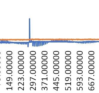

Best reply by shellywang
Please take a look at the data,which was logged as the sensor rotated around its y-axis, with Acc range = 2g, ODR =100 Hz, normal bandwidth; Gyro range = 2000dps, ODR = 100 Hz, normal bandwidth.
After plotting, we did not observe a 10Hz jump. There is a big accelerometer value in the figure below because the sensor hit the desk before it kept  stationary on the desk.
Please give further information about:
  1. Could you please describe more details, for example, how you rotated the sensor, around which axis?
  2. Did you rotate the sensor around an axis in the air or on the desk?
  3. Can you try moving the sensor to another position to avoid some occasional disturbances from the external environment and see what result it is?
