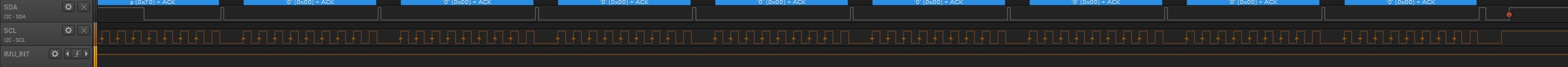

Overall boot and FW upload:

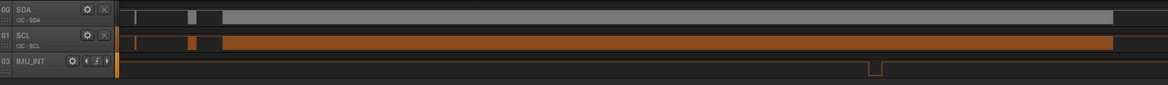

Begin of FW upload:

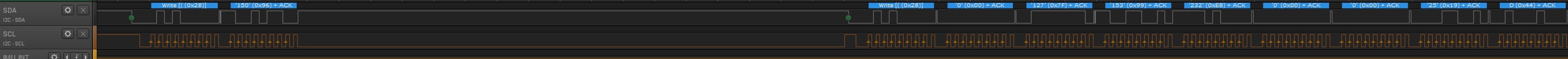

End of FW upload:
