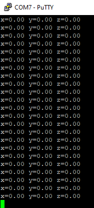

BMI160 Output Zeros
I followed the steps for initializing the BMI160 sensor on Cypress PSoC6 BLE pioneer kit as introduced in this video (https://youtu.be/gyWWnTfdNOQ); however, the output values are always zero regardless of the motion of the pioneer kit board.
Could someone help me figuring out what I should do to get the correct output values?
Thank you.

        printf ("x=%1.2f y=%1.2f z=%1.2f\r\n", gx, gy, gz);
