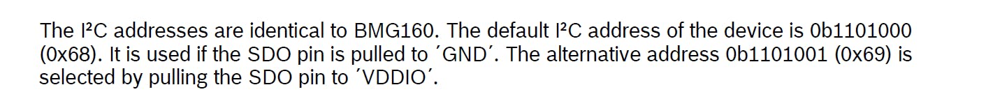

Hi ShanM,
BMI160 I2C address should be 0x68(SDO pin low) or 0x69(SDO pin high), refer official data sheet https://www.bosch-sensortec.com/media/boschsensortec/downloads/datasheets/bst-bmi160-ds000.pdf
