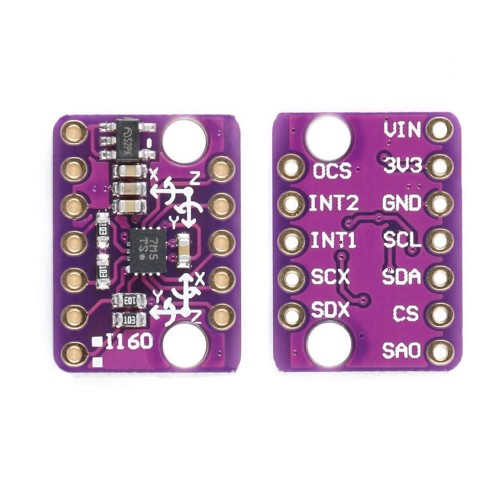

Which terminals will be used for Spi4 wired connection? The picture of the sensor I am using is as follows. No terminal named (SA0) is defined in the datasheet file, but there is such a pin connection on the sensor. There is no such tip in the diagram given on page 103 of the datasheet file. Is this pin shown as SD0?

Thanks for your inquiry.
Yes, you are right. The SA0 pin on the breakout board is to select I2C slave address for BMI160. It is the same pin as BMI160 SDO pin-1 which can be used as MISO in SPI interface.
