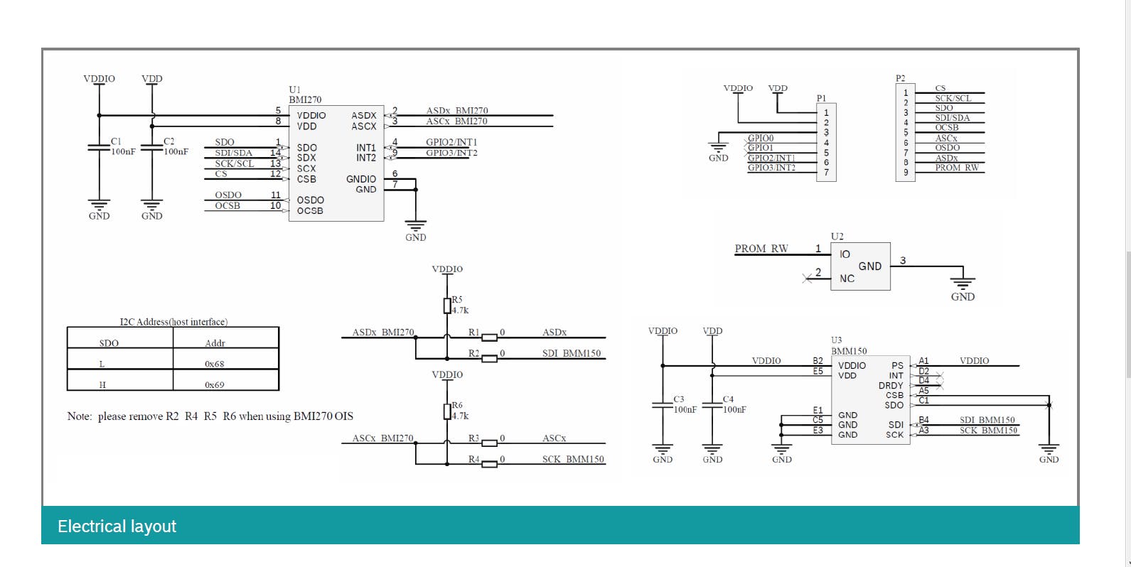

Hi Team,
I'm using BMI270 Shuttle board 3.0 + BMM150 mounted on it to read data (Acc, Gyro, Mag). Present we are reading data using interrupt method. According to BMM270 datasheet when data is ready it need to generate interrupt (Falling). But interrupt is not generating by sensor, until and unless we move it by our hand. Using INT2 for interrupt detection in P1 see below image. Here we are unable to find what's happening.
Why interrupt is generating only when we move/touch interrupt pin.? Please help me to resolve this issue. please find the attached code which reads Acc, Gyro, Mag data. Do I need to do anything to generate interrupt by sensor.
I will provide more info if required. Any help would be very thankful.
