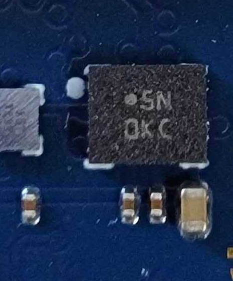

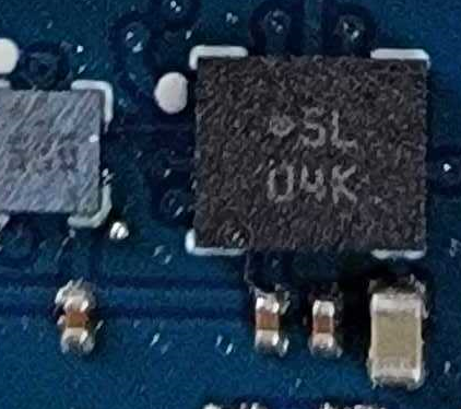

Examined the chip and found that the markings on the "working" BMI270 says "5L-U4K" (may be an "O" instead of a "U").  The "non-working" BMI270 says "5N-OKC".  See attached pictures.  So finally, took the chip from the working board and reflowed onto the new board.  Suddenly works.

1) What is the "5N-OKC" chip?  What product do you have that reports CHIP ID as 0x26?  My hope is that you simply sent the wrong but footprint compatible part to my CM.
2) If it is an IMU type chip, can you please provide some documentation for it so I can make the appropriate changes to the software?  I have 350 of a 400 unit batch that was built probably from the same reel.  I would prefer to just make a software change to fix this.  Please don't tell me that these are just defective BMI270 chips.  I don't really have the time, nor can I afford to have all these units reworked.
