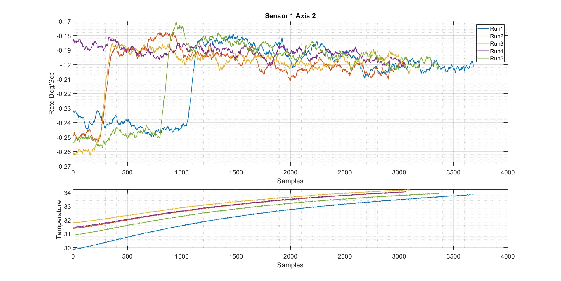

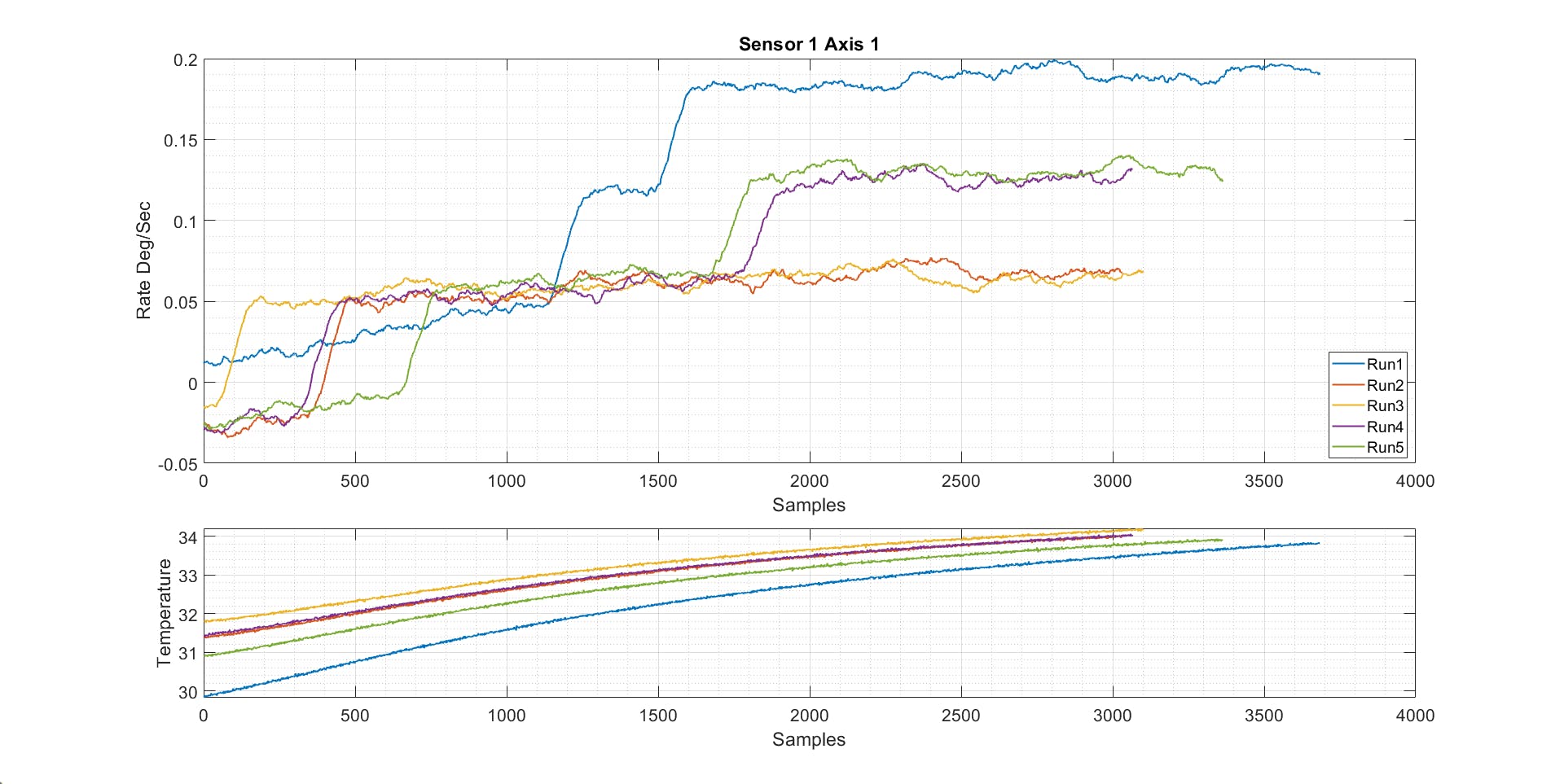

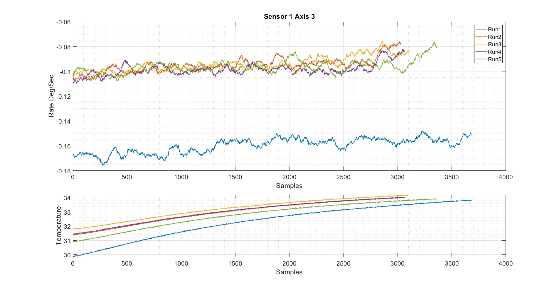

A random change is observed in the bias values of BMI270 Gyro data in its stable state. This change in the zero-rate offset values is random and can be seen on all X, Y, Z axes. Also I have used the latest BMI270 API version. BMI270 is tested on different boards to ensure that the issue is not board specific. The Gyro data output remains to be erratic. I am using only the Gyro for my application. Hope this is not the expected behaviour.
Any explanation on why is it so? Has anybody else observed this issue with BMI270?
Graphs attached below. Hope to get a reply back soon.
