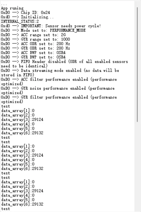

Using STM32F103 to communicate with BMI270 via IIC, I can read the chip ID, but I have not been able to load the configuration files, can you help me to see the problem?
Serial debugging information and source code

void load_config_file(struct bmi270 *sensor)
printf("0x%x --> Initializing...\r\n", BMI270_I2C_ADDR);
write_register(sensor, PWR_CONF, 0x02);
HAL_Delay(5);
write_register(sensor, INIT_CTRL, 0x00);
sensor->internal_status = read_register(sensor, INTERNAL_STATUS);
if((sensor->internal_status & 0x01) == 0)
for (int i = 0; i < 256; i++)
write_register(sensor, INIT_ADDR_0, 0x00);
write_register(sensor, INIT_ADDR_0, i);
write_register_block(sensor, INIT_DATA, 32, &bmi270_config_file_data[i * 32]);
write_register(sensor, INIT_CTRL, 0x01);
IWDG_Refresh();
HAL_Delay(20);
printf("INTERNAL_STATUS:%d\r\n", sensor->internal_status);
if (sensor->internal_status & 0x01)
printf("0x%x --> Already initialized!\r\n", BMI270_I2C_ADDR);
  else if (sensor->internal_status & 0x02)
    printf("0x%x --> IMPORTANT: Sensor needs power cycle!\r\n", BMI270_I2C_ADDR);
