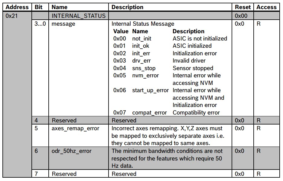

2. After downloading a config file into the board, we need to check 0x21(init_status)
3. I read 0x21 data after downloading config, 0x60 comes out.
4. As seen in datasheet, 0x60 means "axes_remap error" & "odr_50hz_error"
5. I tried to handle registers, but every modification didn't really make any significant effect to error.
