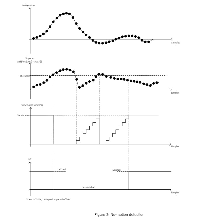

I am terying to understand the No Motion visualisation presented through Graphical images on the page No 46 of the datasheet.
As per the image, the slopw in second graph should be zero, when acceleration is peaking (in first graph).
Can someone explain this behaviour, or how are we actually calculating slope of Acceleration and how to relate that to the second graph?
