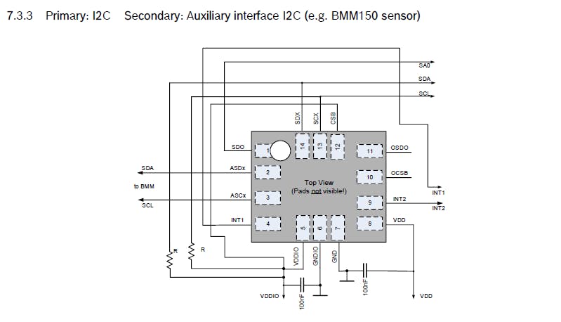

I'm searching a way to raplace BMX160 in my project, and I would use BMI323 with BMM350.
I wolud konw if BMI323 could have the possibilty to connect direcly with BMM350 like BMI270 and predecessor, using PIN 2,3,10,11 like the figure below

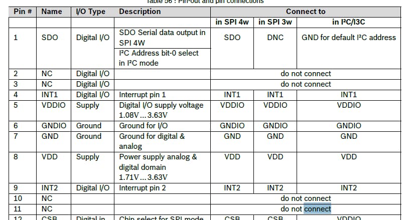

In the datasheet this pin are marked like Not connect.
