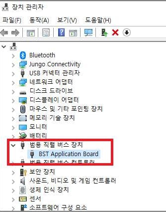

1. EVBoard USB Connect
2. Device Manager driver recognition
3. Development Desktop 2.0 Start

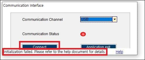

4. Attempt to connect by pressing the Connect button
The EVBoard does not work as above.
Also, the program is not able to connect.

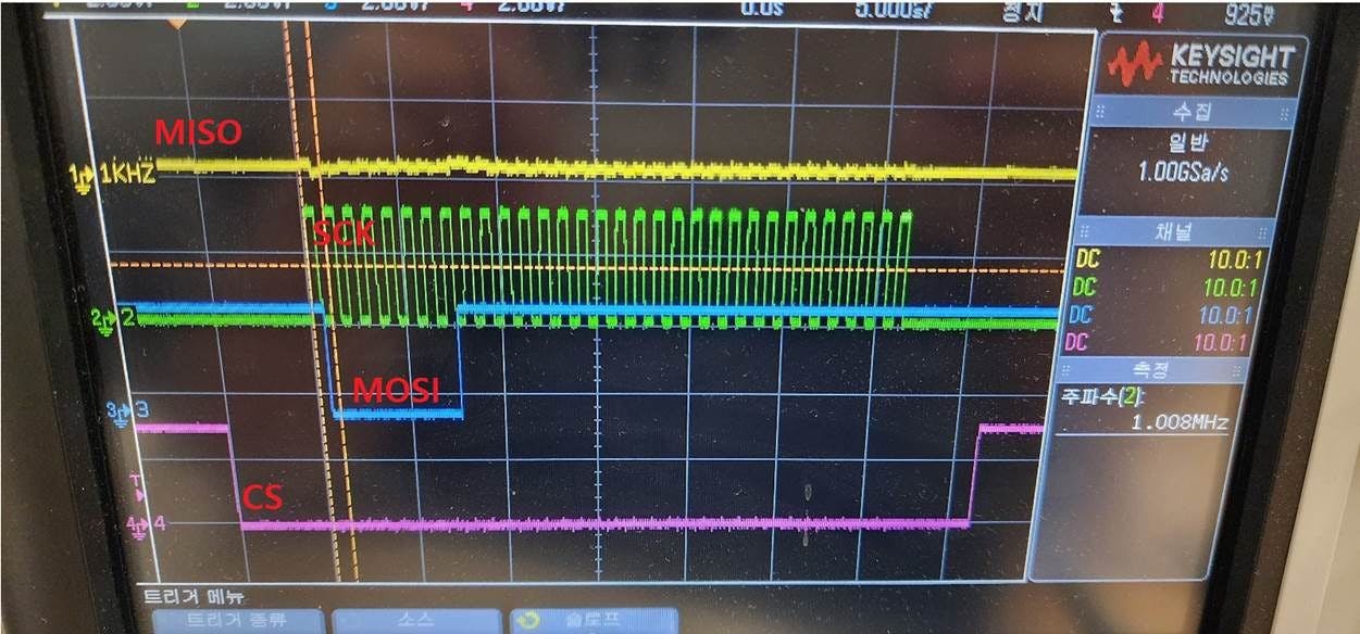

Below is the SPI communication status with our Main MCU.
1. Board connection, based on the right circuit diagram, the left 3 pin is connected to power and the right 4 pin is connected to SPI 4Wire.
2. SPI Interface (Dev ID Read)
As shown above, SPI communication has successfully sent commands, but there is no response from the actual sensor.
Is there anything we're missing? Or is it broken?
